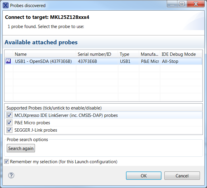

cant program Fredom KL25Z demo board or debug with MCUXpresso IDE 10.0 using PE micro open SDA link server flash programmer tells me there are no probes attached

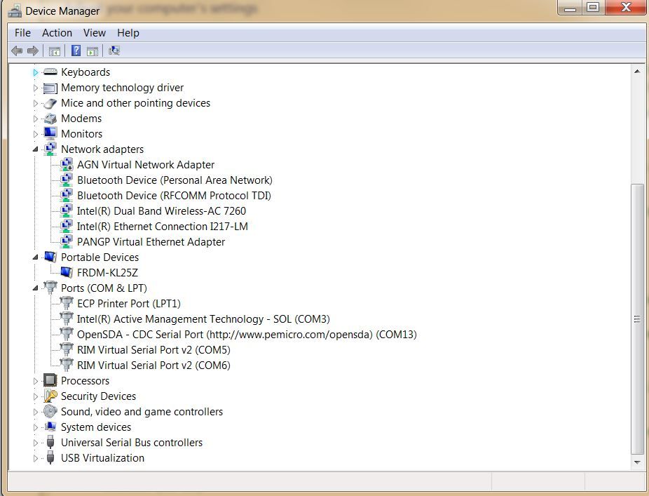

Just to check the obvious: I assume you have the P&E OpenSDA firmware loaded on the board and it has enumerated as a debug probe (check your device manager)? And of course you are using the OpenSDA (and not target) USB port, correct?

I believe this is some kind of tool setup issue, or maybe driver issue,  I think Eclipse is looking for an actual debugger probe, like a JLINK or PEMICRO Multi,   when I am using onboard PE_OSD?

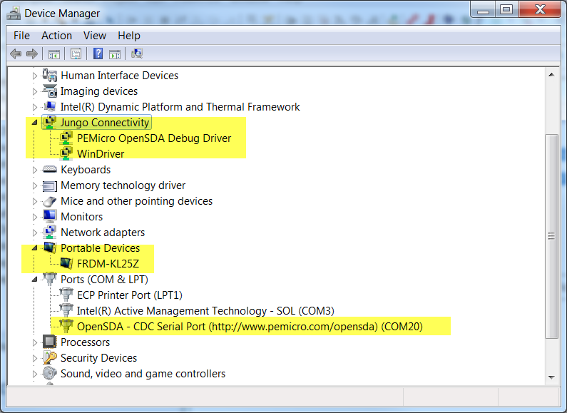

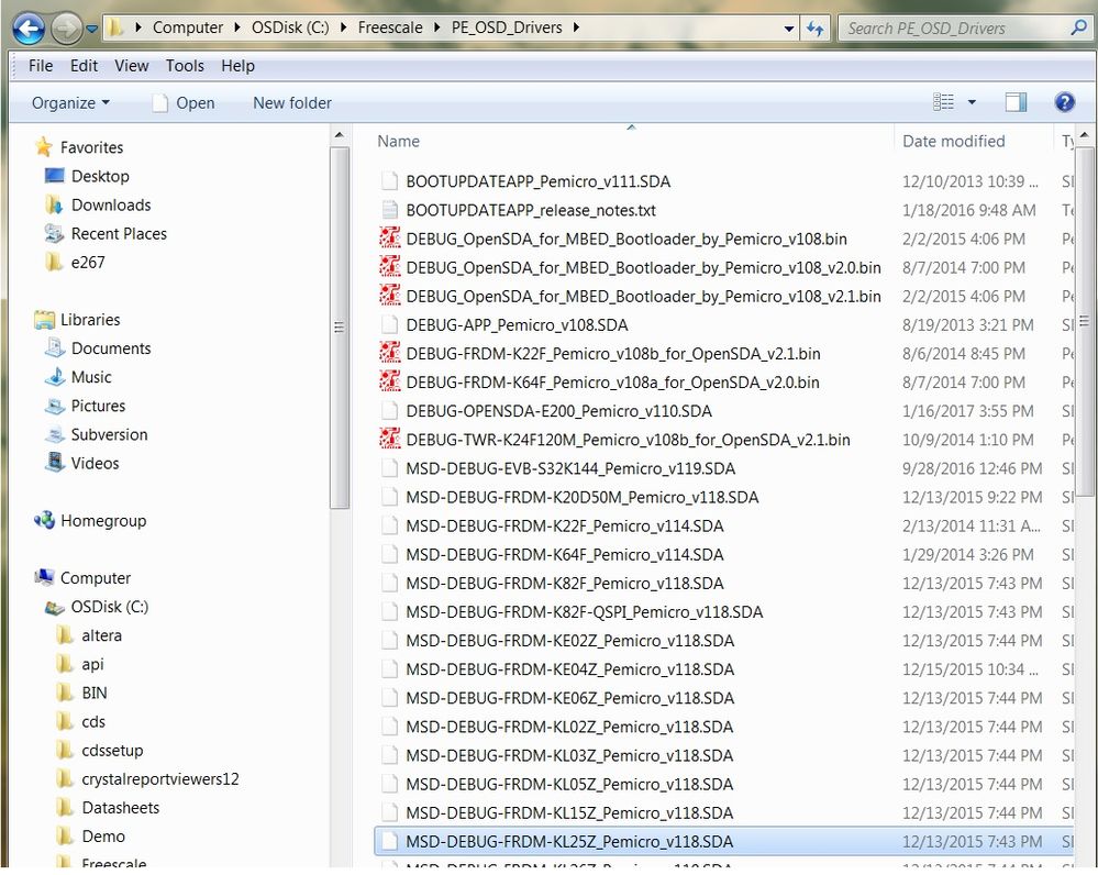

Carlos_Mendoza
Hi Jeff,
Please try loading the latest opensda firmware to the board, I just did a test using a KL25Z board with this firmware and it is working correctly.

I think it was a configuration problem,  If I click on the blue Bug in MCUXpresso, it actually works now, if I click the green Bug something goes wrong,  and the icon next to the debug is different I think this is related to Eclipse Run Configurations setup,  is there any notes on the proper way to set up configurations?

jeffsylvester
thanks Carlos,  I downloaded directly from PE Micro and did this update yesterday, looks like something still not working, do you think this is an eclipse settings issue, or maybe a USB driver?

jeffsylvester
I assume I have Opens SDA loaded, it shows up in device manger, and I got the board at a training long time ago, we went through steps to make the board do stuff...   now actually trying to use the board for actual application,   I am just trying to program one of the many free example code, and the program part is barfing,   Board Setup.JPG
