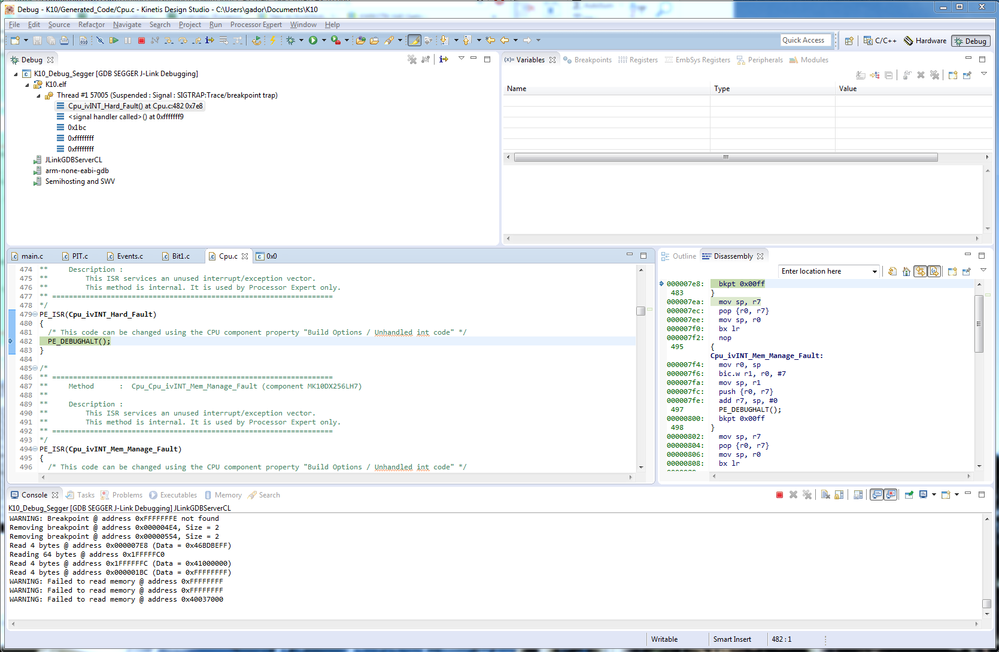

I am currently using Kinetis and Processor expert to program MK10DX64VLH7 processor. I added a PIT (Init_PIT) component to be able to toggle one of the output pins but it's not working. I decided to try and use the GDB SEGGER J-Link for debugging but it always stops at either Cpu_ivINT_Hard_Fault or Cpu_ivINT_Mem_Manage_Fault.
Could you help me fix this issue?

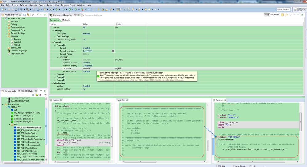

You can refer the attached project and images. I am using KDS3.2 and Processor Expert.
Robin

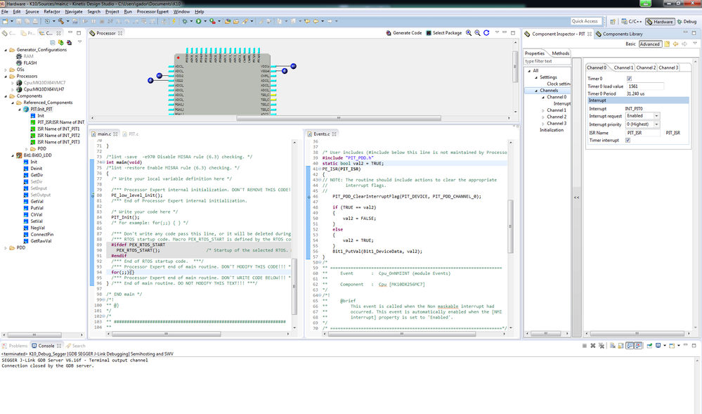

I already modified my code to make it similar to yours but it's still stopping at Cpu_ivINT_Hard_Fault. The only differences I can think of between our settings are the timer load value and the base clock frequency.
I also attached my project for your reference.

You can take a photo, just like below:
Robin
