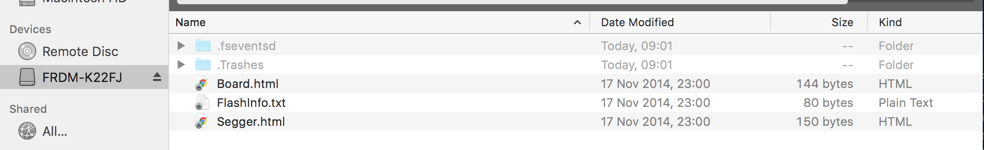

I have a new Freescale FRDM-K22F board. I'm unable to load any programs onto it.
When I attempt to load the program I get the following error message from JLinkGDBServer: ERROR: Failed to prepare for programming
Here's my working environment:
Host OS: Mac OS X 10.11.5 El Capitan
Toolchain: GNU ARM (gcc-arm-none-eabi-4_8-2014q3)
Firmware: SEGGER OpenSDA 2.1 generic firmware from https://www.segger.com/downloads/jlink/OpenSDA_V2_1.bin
JLink: V5.12i Command Line Version from https://www.segger.com/downloads/jlink/JLink_MacOSX_V512i.pkg
Here's what happens when I attempt to load the hello_world example:

Hi Don Turner
The LED next to the MK22F on is no normal, It means that the Target can be halt.
It seems to be a version problem with the firmware for FRDM-K22F. Could you try with the attached file? Again the same process, holding down the reset button and then connect the USB cable, copy the firmware to the bootloader, disconnect and reconnect and then try to program. (If a message proms that tell you to erase the device to unsecure please click "yes" immediately).
Please try this and tell me what you get and if you have any question also tell me.

donturner
Thank you! That fixed it. Now I can upload programs and debug properly.

donturner
Thanks for your help. Here's the steps I went through (just in case I'm missing something obvious).
1. Reboot the device into bootloader mode
2. In terminal do the following:
sudo mount -u -w -o sync /Volumes/BOOTLOADER
cp -X ~/Downloads/01_OpenSDA_FRDM-K22F.bin /Volumes/BOOTLOADER
The board immediately reboots. The LED next to the OpenSDA port is green, the LED next to the MK22F is red (is that normal?).
3. Verify that the OpenSDA firmware is installed. It is:
4. Load KDS and attempt to debug a "hello world" program. Same error as before "ERROR: Failed to prepare for programming."
5.  Checked in System information Hardware->USB and the device is *not* listed. Could I have a faulty board?
