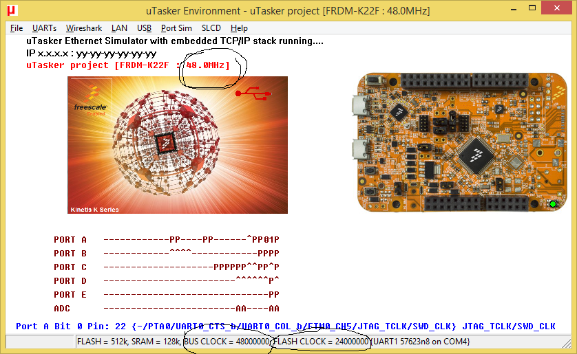

Eg. for direct IRC48M clocking (no PLL/FLL):
#define RUN_FROM_HIRC // clock directly from internal 48MHz RC clock
#define FLEX_CLOCK_DIVIDE    2 // 24MHz
#define FLASH_CLOCK_DIVIDE   2 // 24MHz
#define BUS_CLOCK_DIVIDE     1 // 48MHz
#define USB_CRYSTAL_LESS // use 48MHz IRC as USB source (according to Freescale AN4905 - only possible in device mode)
The rest is fully automated (no additional coding needed) and below is the result shown by the uTasker FRDM-K22F simulator.
