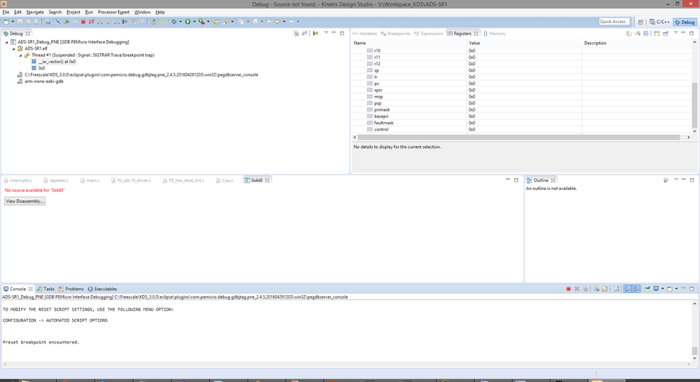

scottm
Senior Contributor II
This is the state of the debugger after encountering the WFI instruction in KDS.  The target is still connected and memory appears to be readable, but all registers are zero.  If you try to resume or step, it thinks it's at address 0.

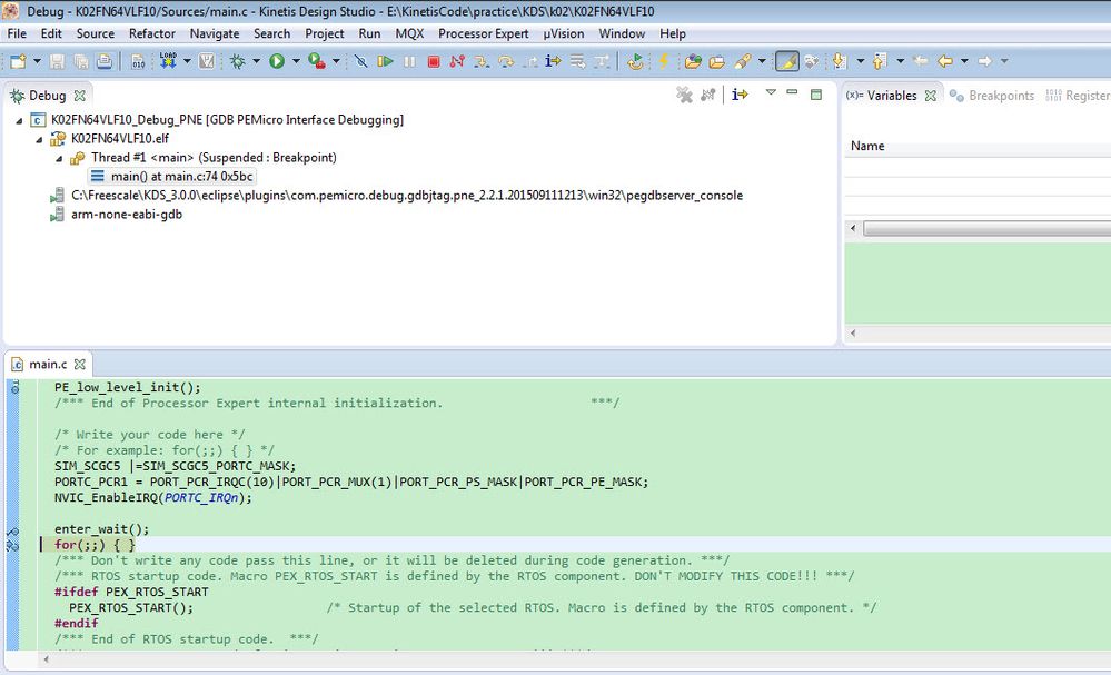

scottm
I do have a FRDM-K22.  I fired it up and added your enter_wait() function to the hello_world project and it stops, exactly the same as the K02.  The same thing happens whether I'm debugging via the Cyclone or the built-in OpenSDA interface on the FRDM board.
10,820 Views
kerryzhou
Hi SCOTT,
    Of course it will stop, because you enter_wait mode, did you try to wake up it?
    If you wake up the MCU, you will find it still working with debugger.
   Use my K02FN64VLF10.rar, and after enter in wait mode, press SW2 on the FRDM-K22 board.
Wish it helps you!
Jingjing
10,820 Views

kerryzhou
Hi SCOTT,
    Could you please try the KDS3.2 software, please download it from this link:
www.nxp.com/kds
    After you install it, and add the KSDK1.3.0 eclipse add-on, then try my project on the FRDM-K22 again.
    If you still meet the same debug error, and the all registers are zero, you need to create a post about the KDS in this link:
Kinetis Design Studio
Wish it helps you!
Jingjing

    Actually, KSD3.0 and KDS3.2 are all working ok on my side after enter the wait power mode, I even try the project which I give you on some colleagues's computer, and I didn't reproduce your problem on our side with the same board(FRDMK22), the same project(K02FN64VLF10.rar), the same debuggers(cyclone, multilink, even JLINK). But you said if you use the codewarrior, it works ok, and just the KDS have problem.
    Because I just the kinetis engineer, I think this problem you need to create a KDS error post on the KDS community, the KDS expert will help you to check it from the KDS software point, whether it is relative to some PC configurations.
   Today, I already see your post on the KDS area.
Debugger resets on WFI instruction
Please also add the error information to that post: no source avaiable of 0X4d8,  the picture which you give me.
  I will also follow your KDS post, if any help need about the kinetis, I will help you.

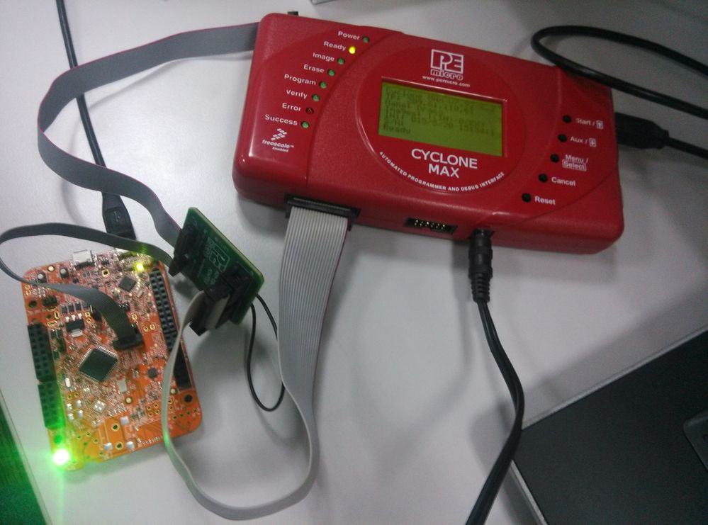

kerryzhou
Hi SCOTT,
    I am using the PE multilink, and test this code on my FRDM-K22 board, because I don't have K02 board.
  After get that you are using the Cyclone, I also try my project with Cyclone USB port,
    Then I also can debug my board.
  If you have the FRDM-K22, maybe you can try this code on our official board.
Jingjing
