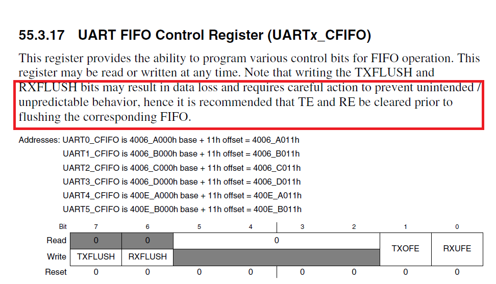

my problem is to flush the RX FIFO of the UART module (MK10DX128VLH7). I don't know
why the FIFO isn't empty if I do the flush command.

      UART1_CFIFO |= UART_CFIFO_RXFLUSH_MASK;                    //That doesn't work!

How did you figure out that the FIFO is not empty after you did the flush operation? Would you please help to clarify?
BTW, The RM recommends disable TE or RE before doing the flush operation, Please kindly refer to the following for more details.

Now, I have solved the problem. The problem was to "believe" in the debugger-register-view...
Have a nice day!
BTW: You were right, I have to clear the RE bit before performing the flush command!
