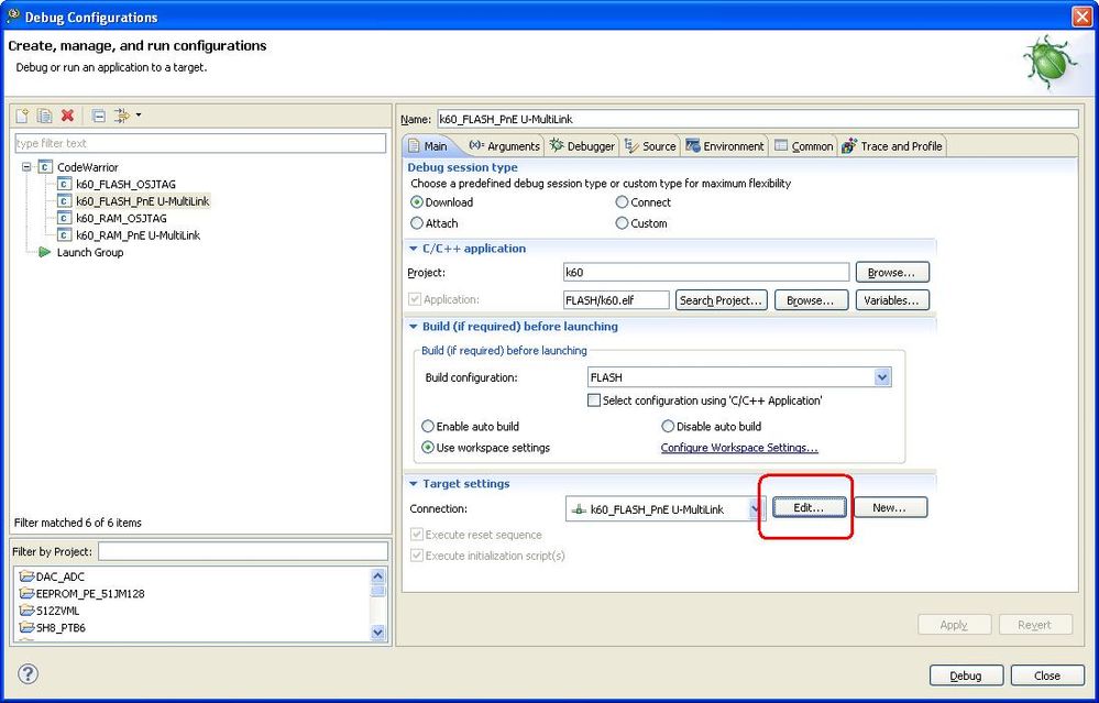

Hi, I need to use the MKE02Z64 with the internal oscillator on a board that was made without crystal pins router nor crystal. I need to increase to max speed (20MHz) but it's only possible by settng the internal oscillator to 39.062kHz so that the FLL could do the rest. The problem is that I can't find a way to do it. Sure processor expert allows me to set that frecuency but when testing it's still running at the default speed (16.7Mhz with 32.768Khz internal oscillator). I only have a JLINK and USBDM, How can I do the trimming? Is it possible with this tools?

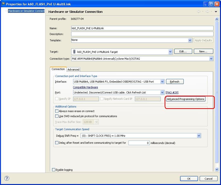

hello Carlos,
we debugger, we can set trim value this way:
1. click on "Edit"
2. Click on "Advanced Programming  Options"
you will setting trim setting in "advanced options"

Thnks but I don't have a P&E Universal Multilink, I only have a JLINK and USBDM. Do you know how to do it with any of this debuggers?
2,102件の閲覧回数
ZhangJennie
In professor Erich blog, a similar challenge with the flash block memory pereserve.
he has found a way to do this with modifying the .arp file, see
Preserving Memory Ranges with Eclipse and P&E GDB Server | MCU on Eclipse
I see that the TRIM value is in the .arp file too. I have not tried to change it, but this might be a possible way for you.

Carlos,
unfortunately this feature is only integrated in P&E interface. JLINK and USBDM don't include trim feature.
