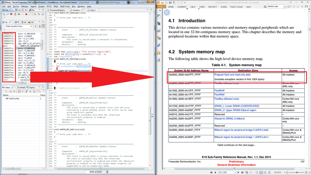

I'm using MK10DX256VLK7 with internal oscillator, the problem is that it runs just when I'm debugging (I use Segger J-Link) but it doesn't run standalone, I'm sure I'm writing the code to FLASH, I have selected the FLASH target and verified code is running from FLASH. Any thoughts about what I'm doing wrong? Thanks.

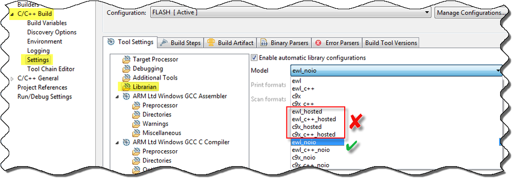

I guess the problem is that you might be compiling with a "semihosting" ewl library.
Please go to Project -> Properties -> C/C++ Build -> Settings -> Librarian, and make sure that you do not have selected any of the "XXX_hosted" options. You can go with ewl_noio.
Hope this solves the problem.

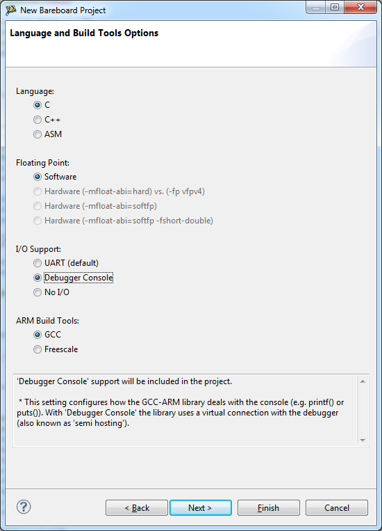

That was the problem, thank you very much Jorge, now I see how inadvertently enabled this when creating my project:
This means now I have no Debugger Console IO support right?

You are right, without one of those "hosted" libraries you have no debugger console support. It is always better to use a UART and a terminal program. In case you really need printfs, you can use the ConsoleIO component. Check the next tutorial:
