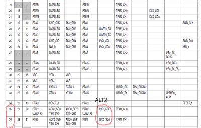

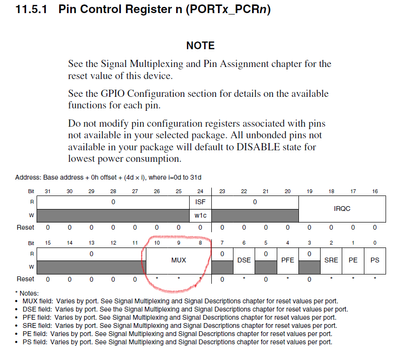

xiangjun_rong
This is the pin assignment of KL16 with 64 pin LQFP
This is the pin mux register
This is the procedure to configure pins:
1)enable PORTB gated clock
SIM->SCGC5|=1<<10|1<<9;
2)configure the Pin35 and Pin36 as I2C0 pins as ALT2
PORTB_0:
PORTB->PCR[0]&=~(7<<8);
PORTB->PCR[0]|=(2<<8);
PORTB_1:
PORTB->PCR[1]&=~(7<<8);
PORTB->PCR[1]|=(2<<8);
Then the PTB0/PTB1 will function as I2C0 pins.
I do not see your code, pls check above description.
Hope it can help you
XiangJun Rong

xiangjun_rong
In the debugger, after the pin_mux.c has been executed, pls check the
PORTC_PCR[8]/PORTC_PCR[9] registers and check the MUX bits if the bits are 2.
You can also use the code:
1)enable PORTC gated clock
SIM->SCGC5|=1<<11;
PORTC_8:
PORTC->PCR[8]&=~(7<<8);
PORTC->PCR[8]|=(2<<8);
PORTC_9:
PORTC->PCR[9]&=~(7<<8);
PORTC->PCR[9]|=(2<<8);
XiangJun Rong
