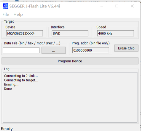

I am working on KW36 micro and I am using J Link Plus debugger to flash the firmware using J Link commander v6.44.
For one of our application, I need to do read/write/erase part of the internal flash. Which caused the device unusable. Tried to do unlock as per the instructions from JLink unlock is successful but fails in erasing the flash.
Please find the below and attached logs from J Link commander:

J-Link>erase
Erasing device...
****** Error: Failed to erase sectors 0 @ address 0x00000000 (Unspecified error
#2)
J-Link: Flash download: Total time needed: 0.066s (Prepare: 0.055s, Compare: 0.0
00s, Erase: 0.005s, Program: 0.000s, Verify: 0.000s, Restore: 0.005s)
ERROR: Erase returned with error code -5.

xing_chang
Hi [email protected]‌,
You can use J-Flash Lite to erase chip.
