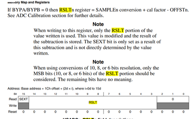

I followed the twrkv58f220m_hsadc_dual_parallel_conversion example for my own project but did not do a differential conversion and the HSADCs do not seem to be converting correctly. I am using the KV56 100 pin part. I expect 2048 counts on Ph A, B, and C below and the voltage matches what I'd expect for 2048 counts but I am getting around 4095 counts. Same below with Dc bus voltage below. I expect 0 counts but seem to be getting a few counts making the voltage reading noisy.

I think I figured this out - my ADC was only reading 0 to 0.38V and then rolling over. The problem was that I did not realize the format of the RESULT register:
The ADC conversion is shifted left by 3 bits. Therefore, I need to shift the value right by 3 bits to read 12 bit 0 to 4095 number.
