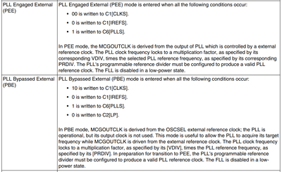

Finally, you are mentioning that you want to use PEE mode, could you please use CLOCK_SetPeeMode() instead of CLOCK_SetPbeMode() and configure it as mentioned in KL81 Sub-Family Reference Manual. Chapter 29.5.1.1. MCG modes of operation?
[KL81 Sub-Family RM. Table 29-4. MCG modes of operation]
