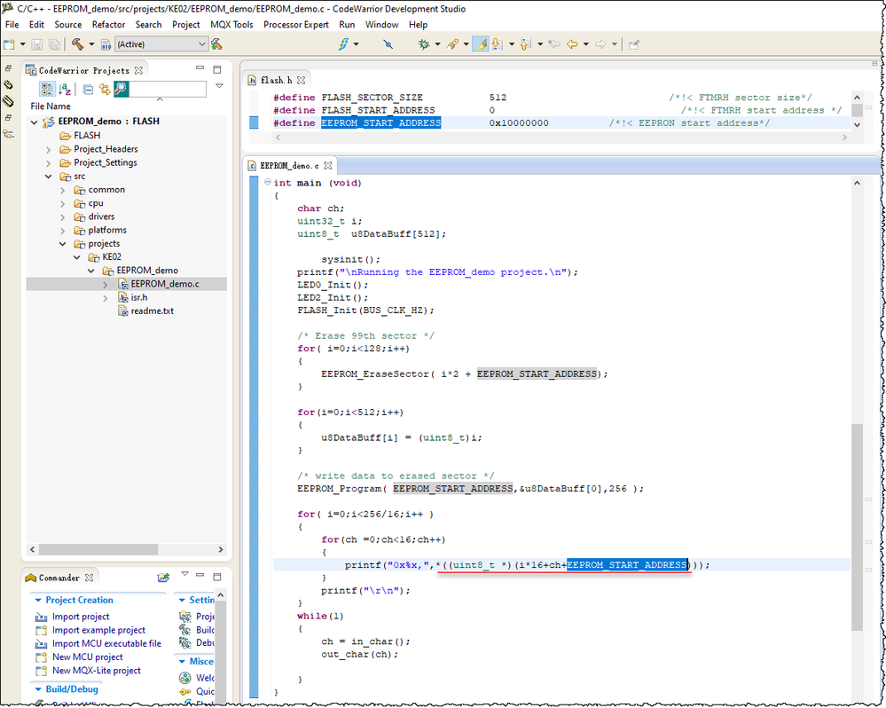

You can find that EEPROM_demo direct read the EEPROM address:

OK I opened the eeprom_demo example .
And from this example :
line:
/* Erase 99th sector */
for( i=0;i<128;i++)
EEPROM_EraseSector( i*2 + EEPROM_START_ADDRESS);
Erase the sector and line :
for(i=0;i<512;i++)
u8DataBuff[i] = (uint8_t)i;
/* write data to erased sector */
EEPROM_Program( EEPROM_START_ADDRESS,&u8DataBuff[0],256 );
 Is writing to eeprom .
And my question is how I can read eeprom data ?

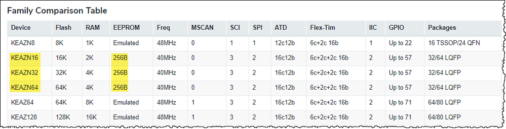

Hi star333,
Please check if your device is KEAZN64 or KEAZ64.
For the device without 256B EEPROM, please refer to the answer in KEA8 EEPROM EMULATION.

I has a mistake that my mcu is not kea64 it is kea16
My MCU part number is "S9KEAZN16AM".
I check the datasheet it has 256B of eeprom.
What I do now?
