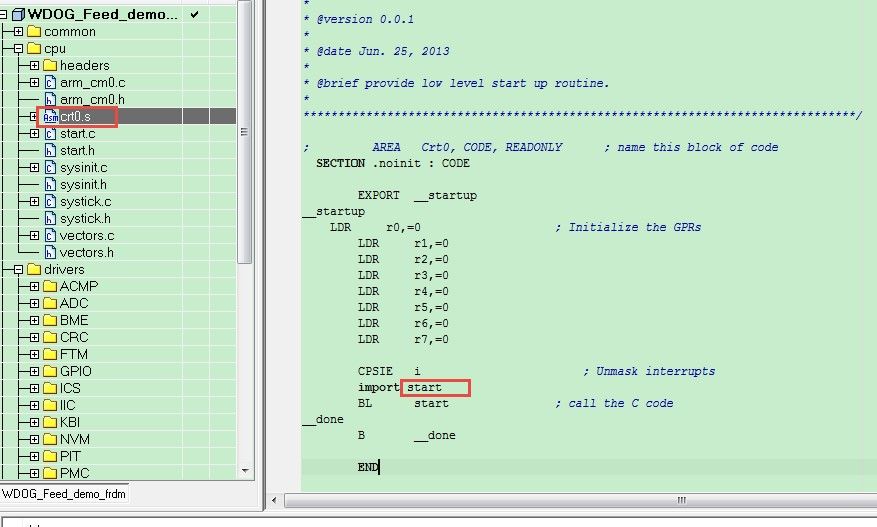

Now how to find the disable code in the start code? Take KEXX_DRIVERS_V1.2.1_DEVD sample code as an example
IAR: from crt0.s, will find the watchdog disable code WDOG_DisableWDOGEnableUpdate();  in the start function.

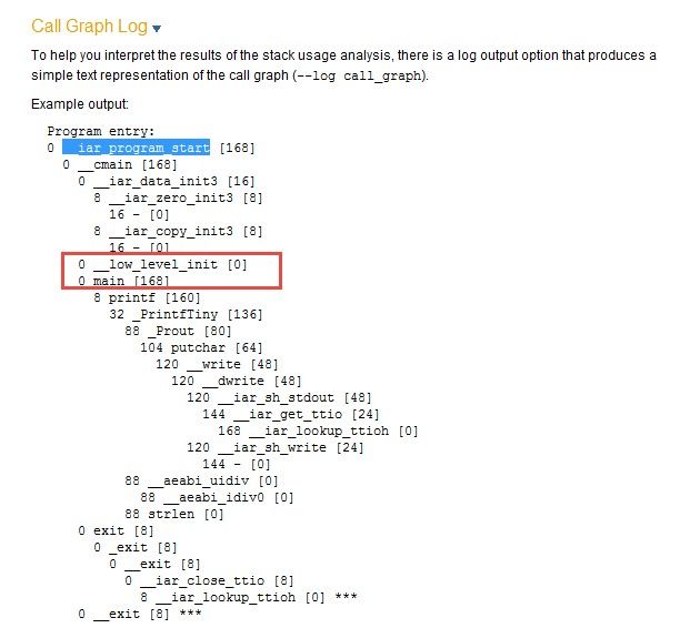

The above IAR start picture is for KE, but in the KEA start file, you can’t see the start function in the KEA sample code which download from the freescale web, just find the __iar_program_start in cstartup_M_KEA128.s after the reset happens, but where is the __iar_program_start function, it can’t be searched in the whole project. Actually __iar_program_start is the default program entry function, it include the following function:
You can find it will enter __low_level_init function, the watchdog disable code is just in  __low_level_init function.

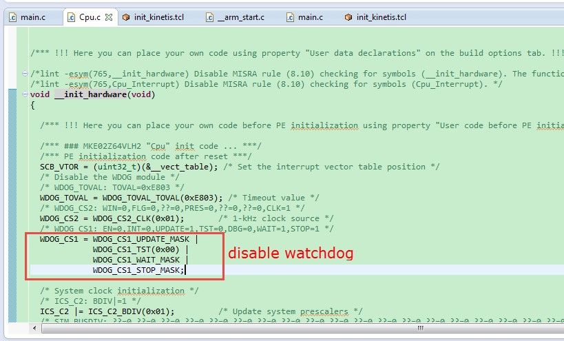

Codewarrior: From __arm_start.c file, will find the watchdog disable code in __init_hardware function.

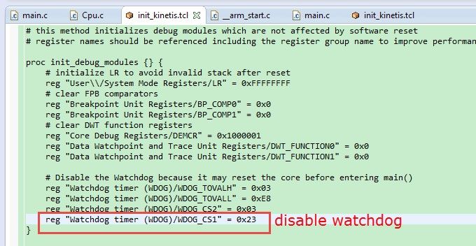

2) Codewarrior script init_kinetis.tcl disable the watchdog
     To the Codewarrior, just comment the disable watchdog code in the __arm_start.c file is not enough to check the watchdog enable after reset, because in the codewarrior connect script init_kinetis.tcl, there also have the watchdog disable code.
     If you want to find the state of EN bit in register WDOG_S1 after reset, you must disable all these watchdog disable code.

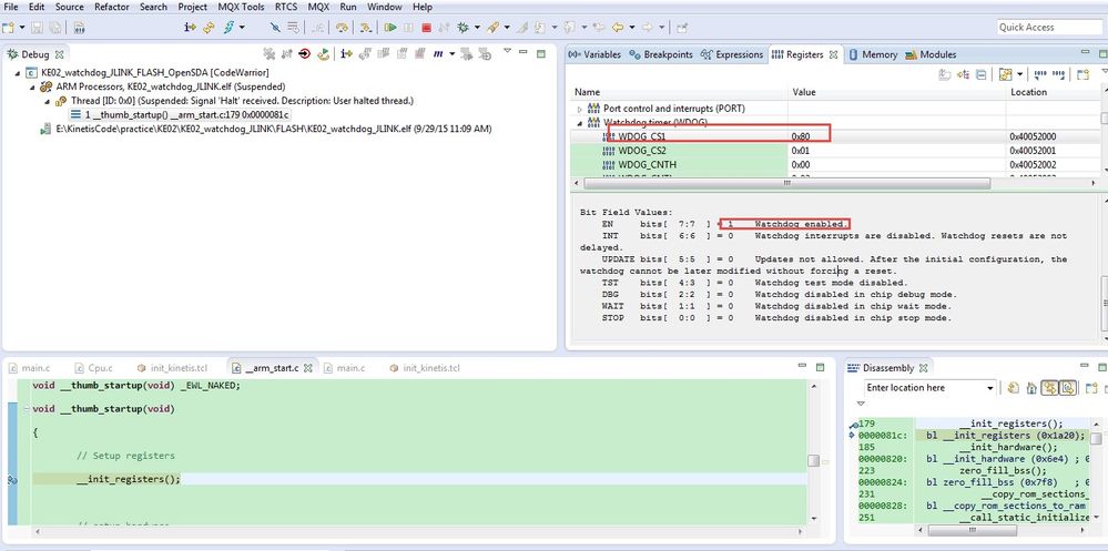

When in debug mode with IDE, some customers find even they comment all the watchdog disable code, they still can’t reset the MCU by the watchdog. After check the register WDOG_S1, bit EN is 0, it means the watchdog is disabled. But from the reference manual, we get that after reset, the EN bit should be 1. What caused this? After test, we find this actually caused by the debugger, the debugger hardware which you are using. Eg, in the same project which already comment all the watchdog disable code, SEGGER JLINK will still disable the watchdog, but the PE opensda or PE multilink won’t do this, the EN bit is enabled by default, the following is the test picture, take codewarrior as an example:
1) JLINK
2) PE Opensda or PE multilink
   So, if you want to test the watchdog in debug mode, and want the EN is set after reset, you can choose PE debugger tool instead of JLINK, but this JLINK feature is just influence the debug mode, after you download the code to the chip flash, and after reset, the EN bit in WDOG_S1 will still be set.
