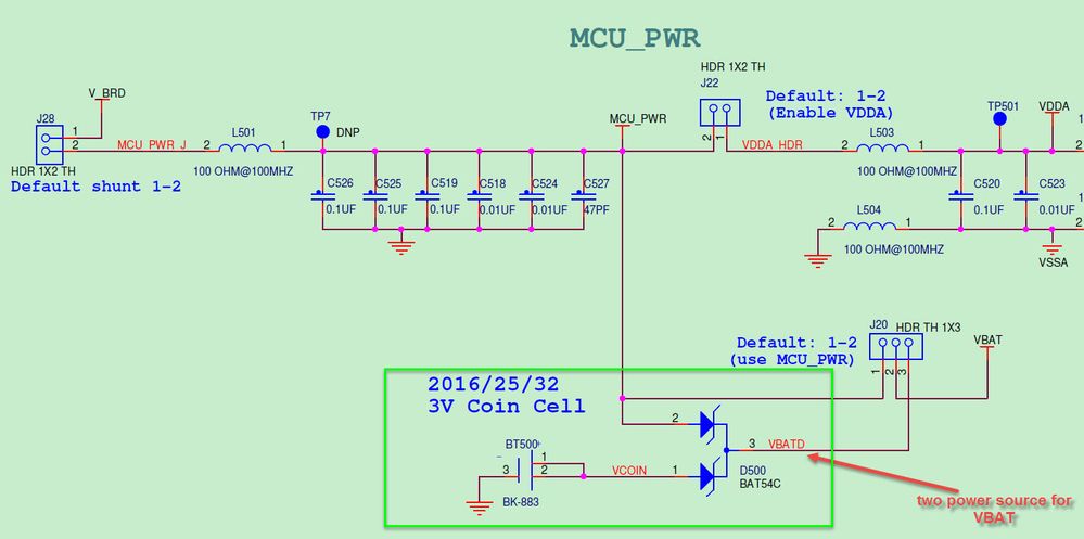

 Hi, I am using MK64FN1M0VLL12 processor and working on RTC. But in the first line itself getting a hard fault. I tried to solve it but failed. can anyone help to solve this problem. External 32.768KHz crystal, Battery connected. Open to any suggestion.

A problem with a hard fault on attempted access to the RTC, even after its clock is unmasked in SCGC6, is likely to be a missing VBAT voltage; without the dedicated power supply the RTC is not powered and thus accesses hard-fault.

Another one could be that you connect VDD and battery to Schottky  Diode. The output of diode to VBAT. This way even if your battery is down you will get voltage from Vdd. In this way there is never a problem of hard fault.
Detection: You can detect the battery(down) by reading RTC register. It will always start from 0 every time you start the board and battery is down.
If you aren't able to understand I am attaching a picture of the circuit.

priyankb
Thank you Mark, you were correct.
VBAT wasn't getting adequate voltage. Changed some hardware, problem solved.
Thank you once again.
