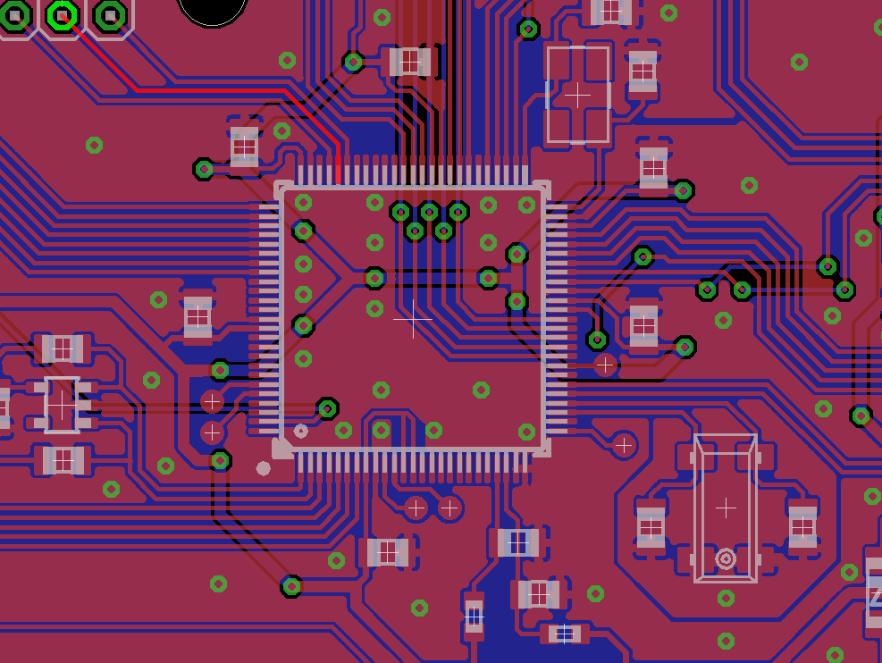

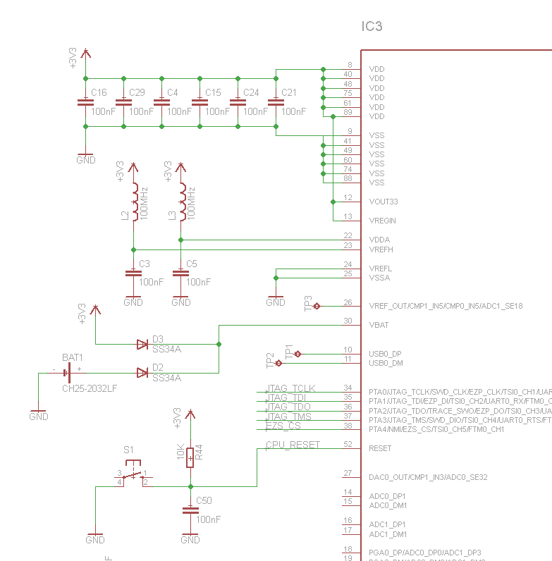

I've tried ADC measurements on my other K60 board and it behaves in the same way... :smileysad: Internal bandgap and internal temperature sensor measurements are correct but measurements on channels 1 ~ 24 are wrong (not zero, but some random value)
Here is part pcb layout and scheme of my other design
10,275 Views
