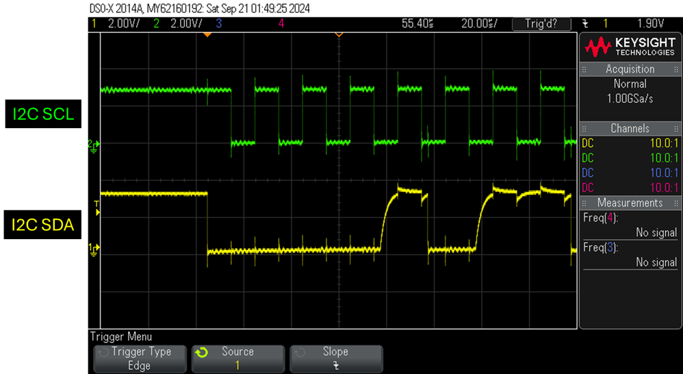

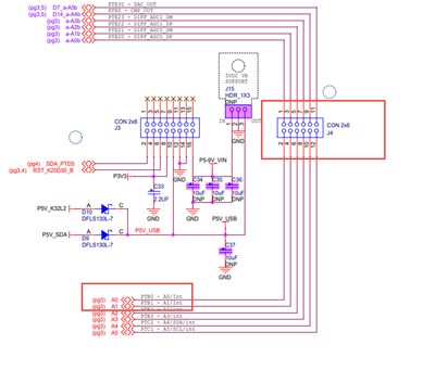

I am using the FRDM-K32L2B3 as master to communicate with a target slave I2C device. The target device needs to be able to hold the SCL line low for clock stretching. However, it appears that the K32L2B3 SCL line is being driven as push-pull: both the rising and falling edges of the SCL waveform are fast, in contrast to the slow rising edges on the SDA line (which indicate weaker pull-up action).
(SCL on yellow CH1, SDA on green CH2)
I have 10k resistors on both SCL and SDA. Below is the pin configuration.

The Reference Manual states "IIC signals are automatically enabled for open
drain when selected." However, my scope trace seems to show this is not the case. Am I missing an open-drain pin setting or I2C setting that permits slave clock stretching when the K32 is used as the I2C master?

I figured out the issue with pin 44. I am trying to use pin 44 as I2C1_SCL. A close look at the FRDM-K32L2B3 schematic shows that this pin is connected via 0 Ω resistor R24 to pin 31 of U7 (the on-board MK20DX128 that provides the OpenSDA interface for debugging the K32).
I don't know what this connection is providing, as it doesn't appear necessary for debug or flashing of the target MCU. (It is also strangely labeled as off-sheet connector `PTC1_SDA`, even though it is not used as an SDA line).
Removing the 0 Ω resistor permits pin 44 to operate as an open-drain SCL for I2C1 as expected.
My apologies for the wild goose chase on this issue. However, it does seem that there should be some documentation regarding the connection of U4_44 (K32) to U7_31 (MK20), especially since pin 44 is explicitly wired to J4_12 (the Arduino Header).

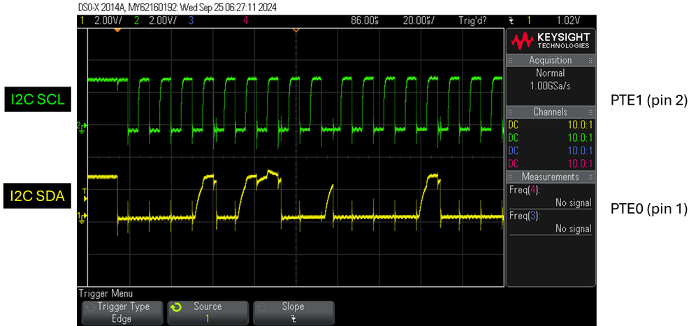

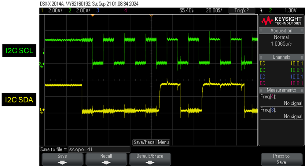

I have the 10kΩ resistors installed at both R81 and R82. However, you can see a clear difference in the traces from my original post: slow pull-up action on SDA, but fast edges on SCL. This is despite the identical pin configurations for the two pins (pull up enabled). So I can already see that SDA has been successfully configured for open drain, but SCL has not.
Nevertheless, I t ried the test you suggested. Below is a comparison of the behavior with 10kΩ pull-up resistors in place, and with 10kΩ resistors removed.
With 10k pull-up resistors
Without 10k pull-up resistors
Summary: the SDA edges are slower without the 10k resistors (as expected... the pull-up strength is now provided only by the internal 20kΩ - 50kΩ). However, the SCL edges remain fast. As you said, this implies that the pin is still configured for push-pull, even though "IIC signals are automatically enabled for open drain when selected" (according to the Reference Manual).

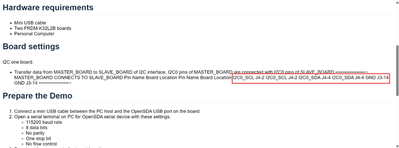

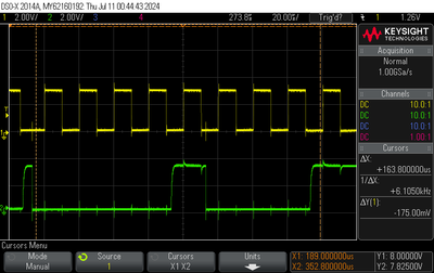

I conducted some tests using the frdmk32l2b_i2c_polling_b2b_transfer_master demo in SDK.I configured the FRDM-K32L2B board as the I2C master to communicate with another board.The configuration and pin setting are as follows.
I have tested the signal of SCL, this letter is without pull-up resistor, you can see the information in the picture, and yours is different.
Hope it can help you.

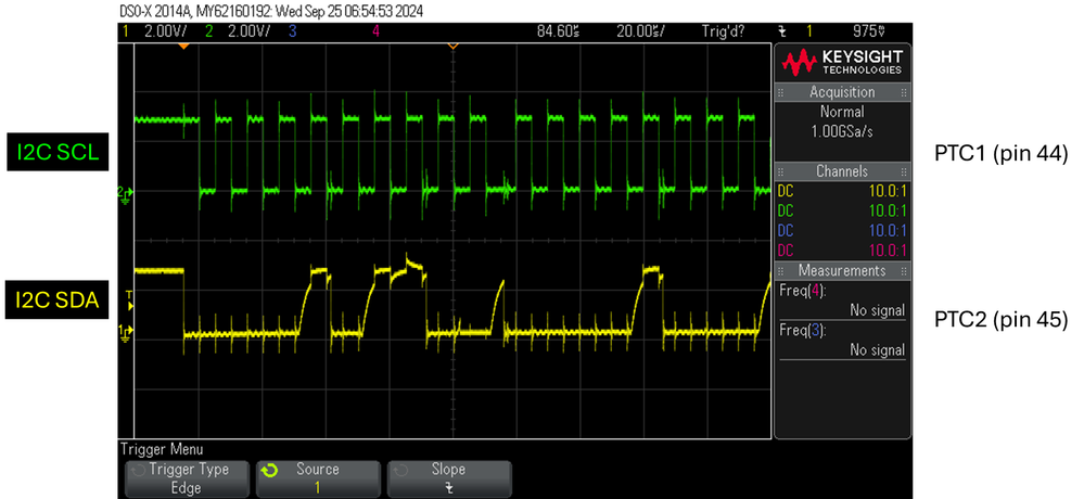

Below I show scope traces for the 3 scenarios described above, along with the pin configuration for each. Note that the pin configurations generated by MCUXpresso Config Tools are identical.
1. Successful communication with I2C0 (open drain SCL)

aberger
Senior Contributor I
Hi @Joey_z ,
Thanks. Can you clarify why the connection of the SCL line to the MK20 pin was causing that behavior?
3,090 Views
Joey_z
hi,aberger
I suspect that the configuration of pin 44 (I2C1_SCL) on the K32L2B might be impacted by the PORT configuration of the MK20, because the MK20's PORT configuration could override the default I2C settings. You can use a multimeter to check if the PORT on the MK20 side has a pull-up.
