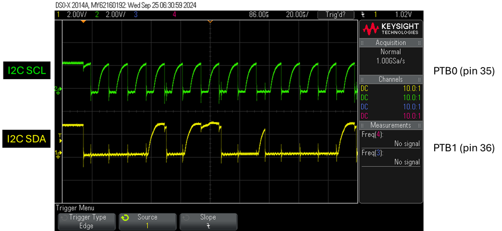

I am using the FRDM-K32L2B3 as master to communicate with a target slave I2C device. The target device needs to be able to hold the SCL line low for clock stretching. However, it appears that the K32L2B3 SCL line is being driven as push-pull: both the rising and falling edges of the SCL waveform are fast, in contrast to the slow rising edges on the SDA line (which indicate weaker pull-up action).
(SCL on yellow CH1, SDA on green CH2)
I have 10k resistors on both SCL and SDA. Below is the pin configuration.

The Reference Manual states "IIC signals are automatically enabled for open
drain when selected." However, my scope trace seems to show this is not the case. Am I missing an open-drain pin setting or I2C setting that permits slave clock stretching when the K32 is used as the I2C master?

I figured out the issue with pin 44. I am trying to use pin 44 as I2C1_SCL. A close look at the FRDM-K32L2B3 schematic shows that this pin is connected via 0 Ω resistor R24 to pin 31 of U7 (the on-board MK20DX128 that provides the OpenSDA interface for debugging the K32).
I don't know what this connection is providing, as it doesn't appear necessary for debug or flashing of the target MCU. (It is also strangely labeled as off-sheet connector `PTC1_SDA`, even though it is not used as an SDA line).
Removing the 0 Ω resistor permits pin 44 to operate as an open-drain SCL for I2C1 as expected.

I suspect that the configuration of pin 44 (I2C1_SCL) on the K32L2B might be impacted by the PORT configuration of the MK20, because the MK20's PORT configuration could override the default I2C settings. You can use a multimeter to check if the PORT on the MK20 side has a pull-up.
