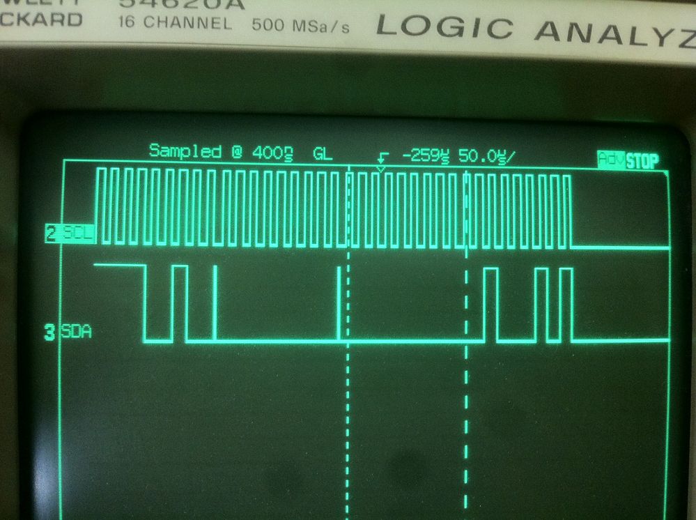

I'm debugging a K20F120 board and running into a problem where the 9th SCL is not issued, somewhere in the middle of transferring (block write) several tens of KB, usually after several hundred bytes.
I noticed the same bug mentioned here: i2c: Is This a Bug?
I'm attaching a logic analyzer capture, where I set the cursors at the ACK bit of the previous two bytes.  You can see the spike on SDA but it's within timing requirements, it's a valid ACK.  So then you can count the Kinetis is only issuing 8 bytes the last time (analyzer set to trigger on a both-low timeout), so the slave has no chance to ACK.
Slowing down the overal timing doesn't help.  Putting  big waits between bytes doesnt help.  Doing one byte at a time doesn't help.  Tried setting the glitch filter to 3, that didn't help.  Eventually this happens....
Bug?  Workaround?

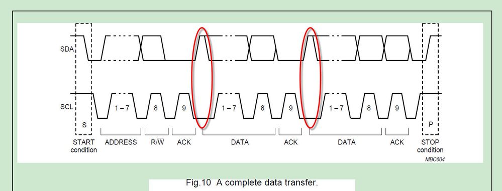

In any case the blip you see is normal I believe.  After the ACK, when the clock goes low again the slave should release SDA, and the master(s) need to wait for this to go high to start another cycle (arbitration).
I wonder how long you ran the test.  You should be able to run it for 15 minutes or so with constant transfers.  Should be way more than 65KB transferred (more like 4.5MB),  as sometimes I could go for minutes before getting the syndrome described.

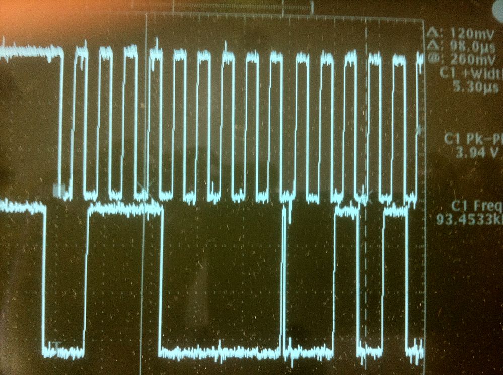

You can get an idea from my scope shot above what the noise is like on the line.  There's about 3 inches of trace on the board, and  2.0KΩ pullups. But unless the noise is causing the K20 to latch up or something, I don't see how it's causing my issue.  It's a possibility - is the K20 sensitive to undershoot/overshoot?  Could that cause something to happen internally?  What is clearly happening is the K20 I2C peripheral is failing to emit the 9th clock pulse, but it's state machine thinks it did and misinterprets a high SDA as a NACK.  I set a breakpoint in IC2_LDD's NACK event and trigger the logic analyzer on a low-SCL timeout, and they trigger consistently on the same event.
Also, in I2C_LDD's ISR, in the branch that first catches the NACK, I put some code in there to disable the I2C peripheral (      I2C_PDD_EnableDevice(I2C0_BASE_PTR, PDD_DISABLE); ) and re-enable.  Set a breakpoint there and stepped thru it, and when I disable the I2C peripheral, SCL goes high, indicating that the K20 is holding it low.
I also tried messing with some of the PORT controls:  passive filter, digital filter, slew rate, drive strength.  None seem to make a huge difference.

The i2c bus is physically probably 4" with 2kΩ pullups to +3.3V.  Two devices on the bus, an ADAU1966 and ADAU1445.  I'm writing to the ADAU1445.  It's about 13KB of data in an array.  The part supports burst mode, where you write the 'register address' (looks like first 2 data words to i2c) then as many bytes as you want.  Here's the code for writing a block (note, it depends on Erich Styger's 'generic I2C' Processor Expert module):

And here's a scope capture of a typical transaction (same part - note, this is not the same transaction as captured by the logic analyzer above, actually it's the beginning of that transaction)
