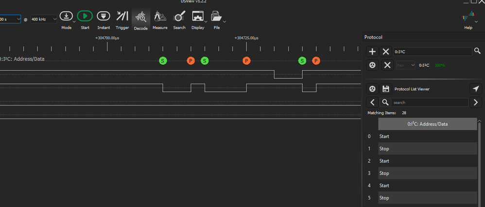

I have connected Logic analyser to SDA and SCL lines of SE051C2 secure chip, i'm seeing the below output
Seems like SE05x is not responding, we have verified the power source.. All fine.

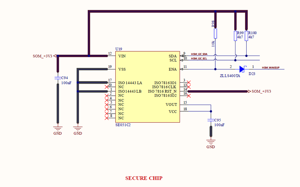

Our schematic is routed like below,
Is this setup is fine? or need changes?

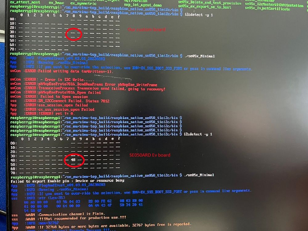

Also, i have used SE050ARD evaluation board to verify the program, it is detected the slave address as 0x48
Same way we have connected to SCL and SDA of our custom board, there is no response in i2cdetect command. please refer the image below,
Skype_Picture_2023_05_25T09_53_24_857Z.jpegSkype_Picture_2023_05_25T09_53_24_857Z.jpeg
Please help us to solve this issue, we have already took more time.

Kan_Li
Hi @Thiru_S ,
Thanks for the information! The schematics looks fine, just wondering if the ENA was kept high in your test, and also please make sure SDA&SCL are not swapped in the connection.
BTW,  C95 is not needed as it affects the ENA reset operation, you know, in case you toggle ENA pin too fast, the capacitor might hold VCC high during the reset, but anyway it should not be the root cause for your case.
