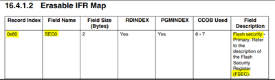

I'm using blhost to write IFR 0x80 to put device into unsecured state.  To do this I must set bits 1:0  in FSEC register to 10.
Since blhost requires 4 or 8 bytes, I am guessing the value I should write is: 0xFFFFFFFE, because the lowest bits in the E = 1110.   But this doesn't work.  I also tried little endian 0xFEFFFFFF, it did not work either.
When I read back 0x80 after writing, it looks like it worked.  When I reset the device (or cycle power), the state is SECURED.  But I expect it to be UNSECURED, since I wrote 10.
What am I doing wrong?
Thank you
blhost -p COM5 flash-program-once 0x80 4 FFFFFFFE

To my knowledge the only way to unsecure the device is chip erase or perhaps backdoor key..
0xFFFFFEFF I believe is the byte order.
The documentation often leaves a lot to be desired.
This details the procedure that you are seeking:
https://community.nxp.com/t5/Kinetis-Microcontrollers/Programming-the-K32L3A-MCU-Flash-IFR-Fields/ta...

Yes, I have read the article you linked.  The example shown is writing an entire register (FOPT) using a single IFR write to 0x84. It makes sense and it's clear what the bytes/bits mean. But I'm struggling to understand how to write individual bits in the FSEC register using IFR 0x80-0x83.
Let's take the case of backdoor key to unlock the device (as you suggested).  To do that I need to set the backdoor key by writing 8 bytes to IFR 0xB0. No problem because it's a "full bytes" type of write, easy to understand. Next I try to set FSEC:KEYEN to 10 by writing IFR 0x83, which is an "individual bits" kind of write, and it doesn't seem to work. See output below.
Any suggestions?

// Program FSEC:KEYEN (bits 7:6) to 10
blhost -p COM4 flash-program-once 0x83 4 FFFFFFBF
Ping responded in 1 attempt(s)
Inject command 'flash-program-once'
Successful generic response to command 'flash-program-once'
Response status = 0 (0x0) Success.
// Program backdoor key to 0xBBBBBBBBBBBBBBBB
blhost -p COM4 flash-program-once 0xB0 8 BBBBBBBBBBBBBBBB
// Program FSEC:SEC (bits 1:0) to 11
blhost -p COM4 flash-program-once 0x80 4 FFFFFFFF
// reset so settings will take effect (also tried power cycle)
blhost -p COM4 reset
Inject command 'reset'
Successful generic response to command 'reset'
// unlock device with backdoor key
blhost -p COM4 -- flash-security-disable BBBBBBBBBBBBBBBB
Inject command 'flash-security-disable'
Response status = 103 (0x67) kStatus_FlashAccessError

I also understand the need to write in multiples of 32-bits, the problem is where in that 32-bits do the bits I'm trying to program go?   For example when I try to set FSEC KEYEN to 10 (see above)?
If I have the IFR write to FSEC:KEYEN correct, why is it not allowing me to unlock using backdoor key?
