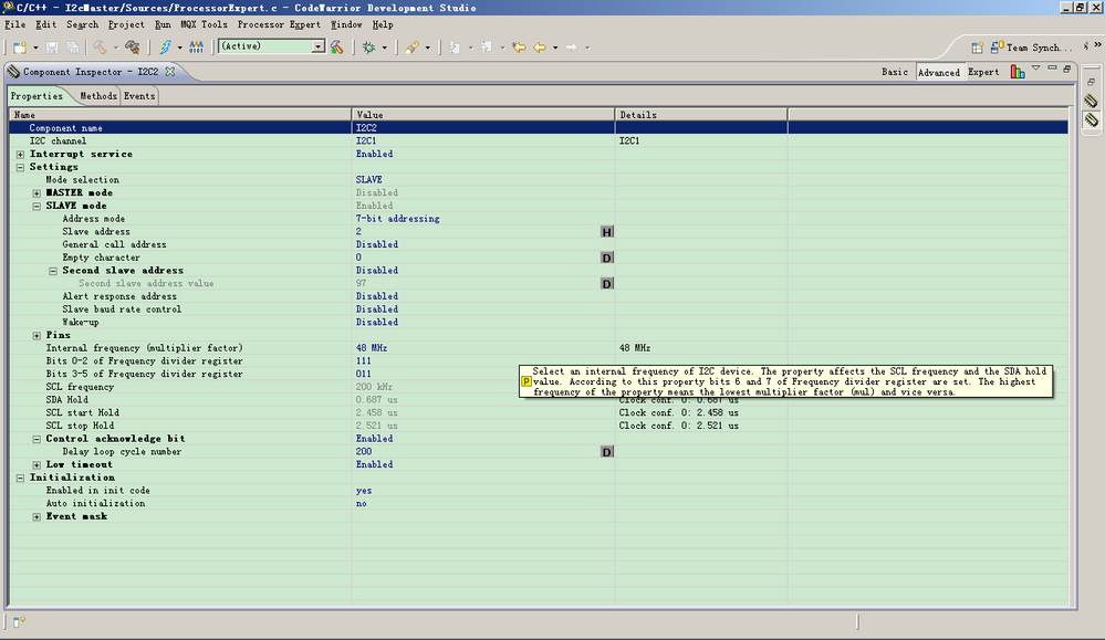

Do you want find where you can enable "I2C2_SendAcknowledge" function in CodeWarrior with PE?
7,077 Views

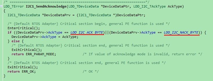

Robin_Shen
Do you want send NACK signal?
I2C2_SendAcknowledge(MyI2CPtr, LDD_I2C_NACK_BYTE);
7,077 Views
jikehe
I use mk10dx256vlq10 mcu, I use codewarrior 10.4 tool, I2C_LDD component Settings->Mode selection selected SLAVE.
