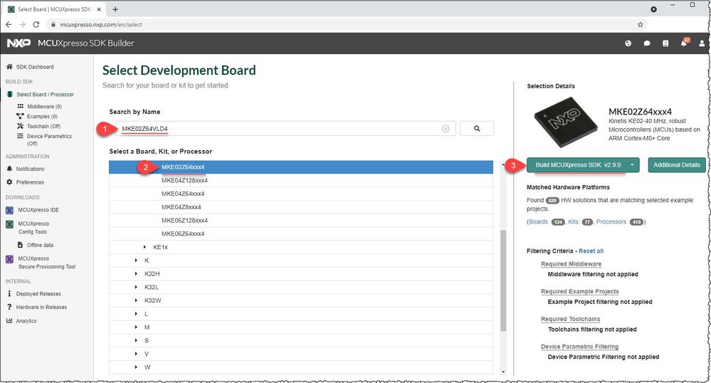

FRDM-KEXX-Driver-Library-Package and KDS is too old.
MCUXpresso SDK and MCUXpresso IDE are currently recommended.
The Clocks tool can achieve it very easily.
select MKE02Z64VLD4.jpgselect MKE02Z64VLD4.jpgClock Tools.jpgClock Tools.jpg
