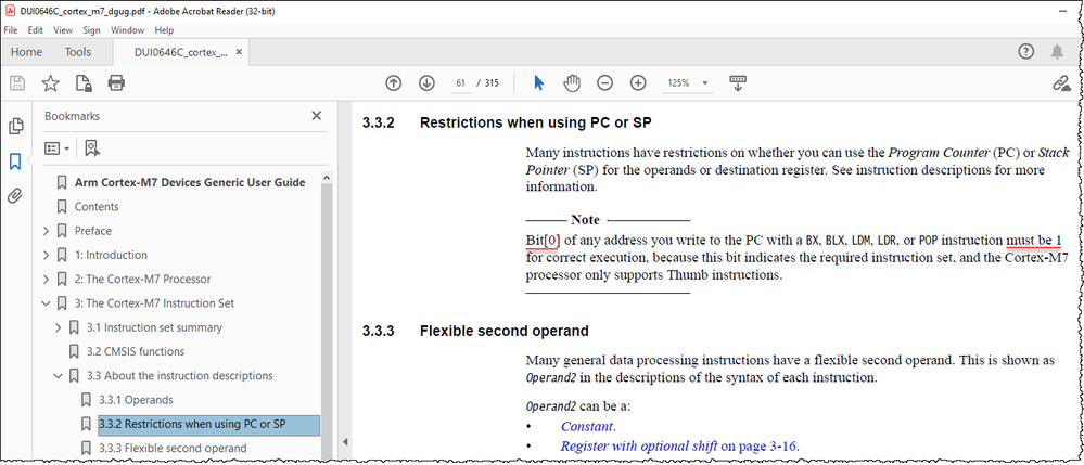

I'm not very familiar with the ARM Cortex core, but I searched for keywords in the Arm Cortex-M7 Devices Generic User Guide and found: Restrictions when using PC or SP. Maybe this is the reason.

By the way:
This problem seems to be related to the use of ARM Cortex. I am afraid that you can get a more accurate answer by contacting ARM's technical support.

My SOFT_1 calls my SOFT_2 which starts at address 0x10081000. In step by step mode, everything goes well but in normal execution I have a HardFault with the PC register at 0x10081000.
The problem does not appear if I call my program at address 0x10081001. And so I try to understand what is the impact of the thumb mode and the EPSR register.

So I understand I shall avoid to call the address 0x10081000 and start to 0x10081001 but without explained it yet.
