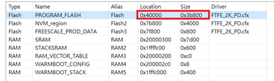

I have two quesetions please see the below :

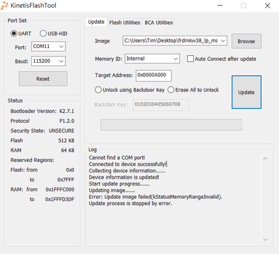

Question 1. When I program app_code ( example : frdmkw38_lp_master_bm ) bin file, the KinetisFlashTool show the error message :
and I modify the app_code flash start address [ 0xa000 ] and size (see the below red box ) :
I think this bin file size over the 256KB ( KW38 flash are two bank =>  256KB + 256KB ) so it can not jump to next 256KB flash bank to finish program action.
as the title, how to program the bin file size over 256KB using this tool ( KinetisFlashTool.exe ) .

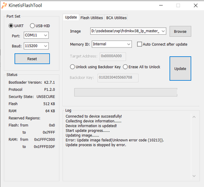

Question 2. I try to modify the app_code flash start address [ 0x40000 ] and size (see the below red box ) :
The tool show the below error:
I think it can not program to KW38 flash bank2 (0x1000000 ~ 0x1003FFFF) ,
Could you give some suggestion for us .
Thanks.

Hi @HCC_T,
Thank you for your response and tests. The Kinetis Flash Tool seems to only access into the P-Flash (Programmable) of the device. The KW38 memory map is as follows:
Even if the flash is correctly configured, the flash arrangement is set. For this issue, I recommend flashing or utilizing the GUI Flash Tool included in MCUXpresso.
For this, Kinetis Flash Tool is not fit for mass production stage.
Unfortunately, NXP does not provide flash programmers for mass production. There are some options for debug and flashing probes, as the MCU-Link.
For mass production programming solutions, there are third-party partners who provide, companies like PEMicro, Xeltek and others. For example, PE Micro Cyclone.
I hope you find this helpful! Best regards, Julián.
