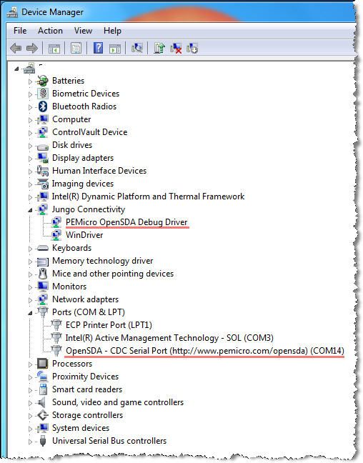

I was going through the getting Started tutorial for the FRDM-K64F and I was unable to download the "Hello World" app into the device.
2,809 Views
Robin_Shen
Would you please give us more information about the question?
For example:
You can attach the error message image shown by IDE.
Check if the onboard OpenSDA is installed.
If you are using Windows 8 and 10, please refer: Bricking and Recovering OpenSDA Boards in Windows 8 and 10
Robin

If you're using it with Windows 8 or Windows 10, there is a known issue where it may get corrupted and the debug interface goes down.  I've been wrestling with the same board, and while I was able to get the OpenSDA debug interface working again, I can't seem to get the mass storage interface working again.  Partly because when I boot it in bootloader mode, the available space reported is smaller than available for the msd/debug application.  This link may help. OpenSDA Serial and Debug Adapter|NXP
Is it showing signs of life at least?  If you plug the USB cable into the SDAUSB connector and plug it into your computer, does the green light come on?  If it's flashing, it may be stuck in bootloader mode and you should see a disk drive showing up in Windows that says "bootloader".  If you download the OpenSDA drivers from Pemicro (you'll need to sign up), the DEBUG-FRDM-K64F_Pemicro_v108a_for_OpenSDA_v2.0.bin file at least seems to restore the debug interface and I can program and debug from McuXpresso.
