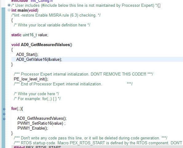

Hi All,
I wrote a program that will take an AtoD measurement that I would like to pass to the PWM to set the duty cycle.
Can someone look at my code (very small) and let me know where I'm going wrong?  Note:  I removed my LED code so it's not so large to read.
Brian
2 返答(返信)
1,935件の閲覧回数
briancavanagh
Hi All,
I found the solution to my problem.  I wasn't including AD0_Start();  in my program (see below).
What I left out in my description above was I'm using a Potentiometer that's connected to the AtoD pin.
Now when I adjust the pot the PWM changes as well.
Brian
