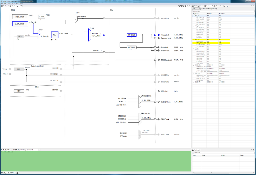

I'm a bit puzzled about what I'm seeing. I've verified that the registers in my KL02Z32 MCU are set up as shown in the diagram below (BTW: love the Config Tool):
When I put the CPU into a very simple loop which toggles an output, it toggles at a rate of about 4kHz:

The KL02 will boot up with a speed of about 22MHz and the setting to get a change to 41.9MHz is to write 0x20 to MCG_C4. Although it is very difficult to read the values in the screen shot I think this is the value that the configuration tools I giving so any problem with speed is likely to be elsewhere.
When I set this to 41MHz and make a loop toggling a port I get about 5MHz output so there is a big difference somewhere.

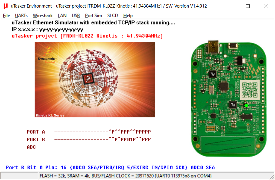

Although it is not as impressive as a drawing tool I can do this in the uTasker project with these two defines:
#define RUN_FROM_DEFAULT_CLOCK                                       // default mode is FLL Engaged Internal - the 32kHz IRC (31.25..39.0625kHz - factory trimmed to 32.768) is multiplied by FLL factor of 640 to obtain 20.971MHz nominal frequency (20MHz..25MHz)
#define FLL_FACTOR          1280                                  // set highest frequency [1464 gives 47.972MHz] (factors available are 640, 732, 1280, 1464, 1920, 2197, 2560 and 2929)
and its simulator immediately confirms such things:
Attached is a version for the FRDM-KL02Z board running at this speed - using the command line interface on the VCOM port [115'200Baud] one can also look at registers (in I/O menu) to see how things are set up - eg. to see the MCG block content:
"md 40064000 b 8" which gives
