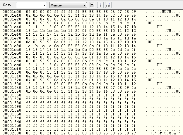

Then it will program erase cycle value to each sector start address, the erase cycle value will occupy 4 bytes with sector start address offset 0:

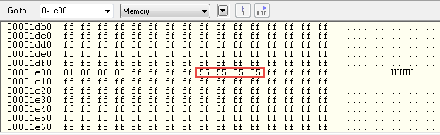

Then make the base sector to be active and program the active indicator at sector start address offset 8. Here the base sector start address is 0x1E00, the active indicator will be programmed at 0x1E08 with active indicator value 0x55555555:
Then it will call Eed_SearchBlankSpace () function to find blank space of EEPROM system, in this demo, the blank space start address at 0x1e0c.
If enable the Flash cache, the cache will be cleared and updated during EEPROM emulation initialize phase.

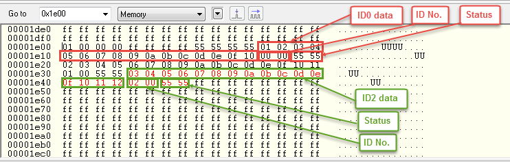

The demo will write eight group data to EEPROM system, each group with 16 bytes data, total data number is 128 bytes. The data located at Flash start address is 0x1e0c. After each group data programming, it will following with the data ID info and program the status.
With all data was written, the all 128 bytes data was programed at 0x1e00 start EEPROM sector.

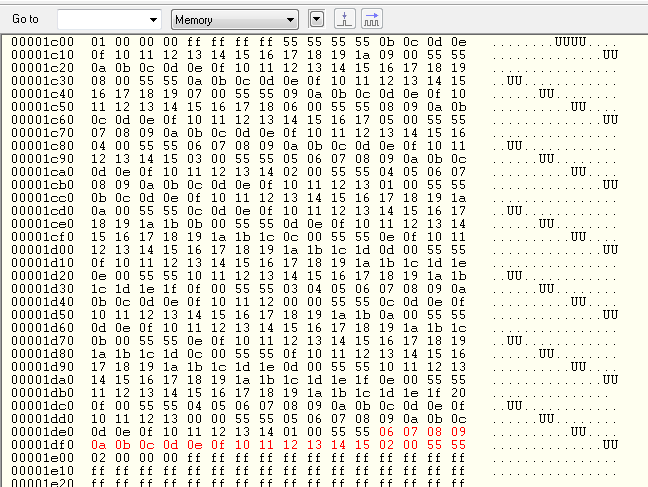

When the write data exceed the active EEPROM sector, the swapping will occur. The swapped EEPROM sector will record previous data and current write data. If there exist sector erase action, it will also update the erase cycle value.
The data is full and the new data written will make swap happens:
After swap happens:
At the end of demo, it will read EEPROM data back and make sure all valid record ID are written to EEPROM emulation.

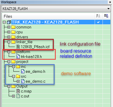

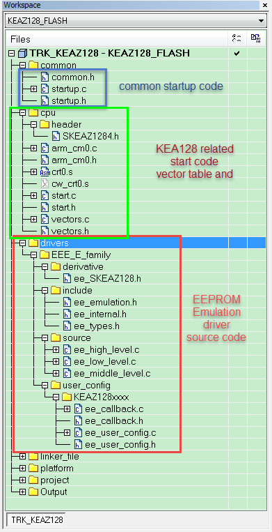

The KEA EEPROM Emulation driver doesn't call the library file, which provides the EEPROM Emulation driver source code.
Please refer below picture about the demo software architecture (IAR):
So, customer can port related EEPROM Emulation driver to Keil project.

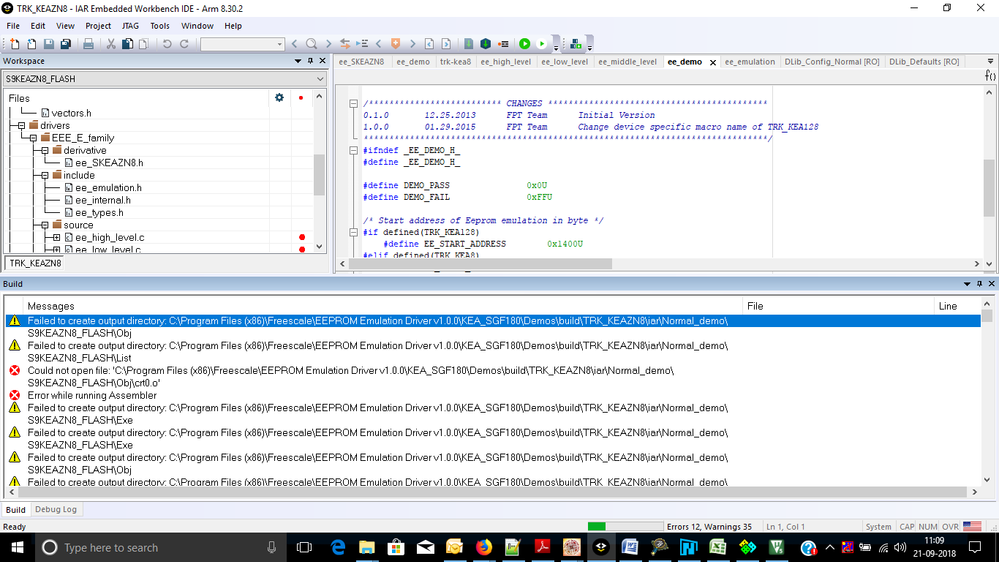

Currently I am developing EEPROM Emulation software and I saw your link which (i.e. you have already developed) which meets our requirement. I downloaded the package mentioned in your post. But I am not able to compile your software under IAR as well as CW IDE.
When i am trying to build package in IAR getting below error.
Kindly help...Looking forward to hear from you.
Sanyam Agarwal
The original project is complete testing with CodeWarrior v10.6 and IAR6.70 on SKEAZN8 and SKEAZ128 devices.
For you are using IAR V8.x, please check with IAR company if there need to install IDE software package to support old version IAR project.
