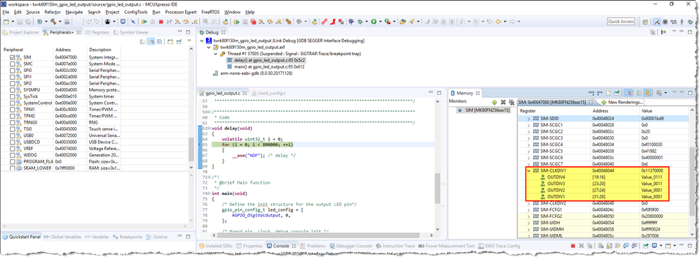

I've got strange problem using SIM_CLKDIV1 to lower core clock on K80
I'm running PLL on this board and i want to be able to divide high PLL clocks to not exceed bus/core clocks limits.
The problem is if i use this:
SIM -> CLKDIV1 = (SIM_CLKDIV1_OUTDIV1(0)| //core
SIM_CLKDIV1_OUTDIV2(1)| // Busclk
SIM_CLKDIV1_OUTDIV3(3)| // FlexBus
SIM_CLKDIV1_OUTDIV4(7)); // Flash
It works, every clock is divided properly but if i try:
SIM -> CLKDIV1 = (SIM_CLKDIV1_OUTDIV1(1)| //core
Write is ignored and i end up with default values. Where is the catch? I read that maximum divide ratio between core and other clocks is 8 but i'm not exceeding this limitations

I am using Clocks tool of MCUXpresso IDE, the GPIO example is able to run after modify the divider.

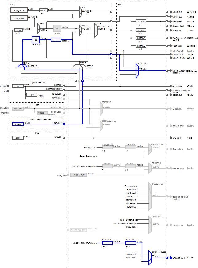

That's really usefull feature in MCUXpresso and now i'm able to set SIM_CLKDIV1 correctly but i noticed that's not perfect.
Not sure if it's bug or i'm doing something wrong but if i want to clock my UART using this tool it's not working properly, wrong clock is selected.
How it's setuped:
Register values in clocks tab :
What i get after i run the code:
And the problem is not only when i want to use PLL to feed UART, it always end up with OSCERCLK clock.

Please check if there is someplace else select the clock of LPUART again.
For example: the lpuart_interrupt will select OSCERCLK after BOARD_BootClockRUN
