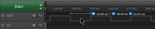

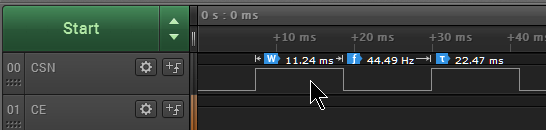

Hi Arnaldo,
For me, the delay time are around 10 ms both for the internal clock and the clock configuration you have. Keep in mind that because it is using a number of nops to wait, the timing is in the ~10% range.
Below is the code for toggling the blue LED (PTD1) on the FRDM-KL25Z:
Default internal clock:
With your clock settings:
The number of wait cycles is based on the core clock:
  #define WAIT1_INSTR_CLOCK_HZ   CPU_CORE_CLK_HZ /* for Kinetis, use core clock as base for instruction execution */
Which 48MHz in that configuration:
#define CPU_CORE_CLK_HZ             48000000U /* Initial value of the core/system clock frequency in Hz.  */
