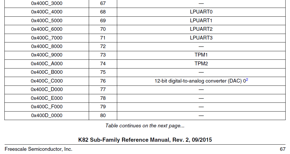

Hi !
It is not so clear from documentation if K82 MPU can be configured for access to simple peripherals (LPUART0 )
in UserMode. All trials to configure LPUART address space in MPU for read/write space dosn't have any effect and simple read of DATA register cause BusFault.
Not all ARM can grant access for this area in UserMode.
But what about K82 ?
Does it possible to configure K82 MPU if in UserMode to have access to LPUART0 and i2C address space ?

xiangjun_rong
Hi, Eugene,
I think the MPU module is used to protect memory rather than the peripheral as the name MPU  implies "memory protection unit".
If you access the peripheral, you can set the AIPSx_PACRn and AIPSx_MPRA register to protect the peripheral.
The LPUART0  module locates at slot 68 of AIPS1 as the Table 5-3. Peripheral bridge 1 slot assignments (continued) which I display as the screenshot.
You can write the AIPS1_PACR68 to set the access right for the LPUART0. You can set the AIPS1_MPRA to configure the different master access right.
Hope it can help you
