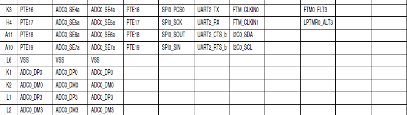

Is there anything unique with pins ADC0_DP0, ADC0_DM0, ADC0_DP3, ADC0_DM3 ?
Is it only ADC input pins (not GPIOs) ?
Can i use those pins exactly as i meant to use the ADC0_SEx pins ?

Hello Eduard,
Do you want to know how to configure the pin to ADC functions ?
If yes ,  you can see the reference manual: 10.3.1 K11 Signal Multiplexing and Pin Assignments ,
we can see ,  these pins "ADC0_DP0, ADC0_DM0, ADC0_DP3, ADC0_DM3" can directly be used to ADC, for these pin only have ADC function.

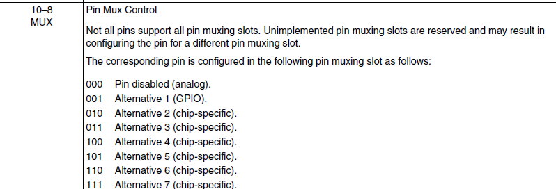

While , for the ADC0_SEx pins , they are multiple function , if we want to use these pin to ADC , we need configure them through  "Pin Control Register n (PORTx_PCRn) "
