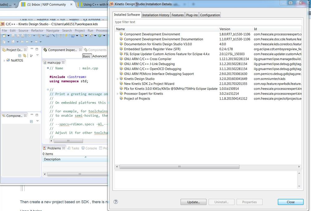

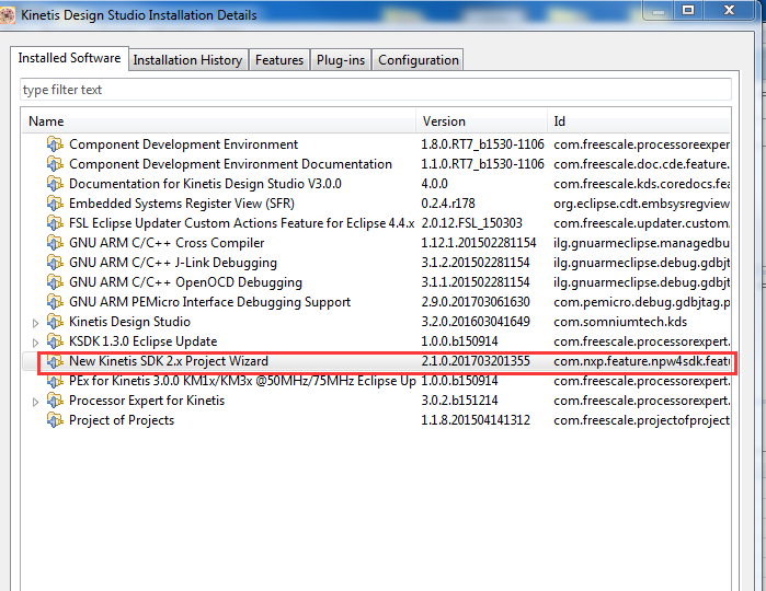

Hello fsa,
- Please download the latest  sdk version  "SDK_2.2_FRDM-KL25Z"
from Welcome to MCUXpresso | MCUXpresso Config Tools
- Install the KDS update about New Kinetis SDK 2.x Project Wizard :
Then create a new project based on SDK , there is no error when build , I have test it on my side .
Hope it helps

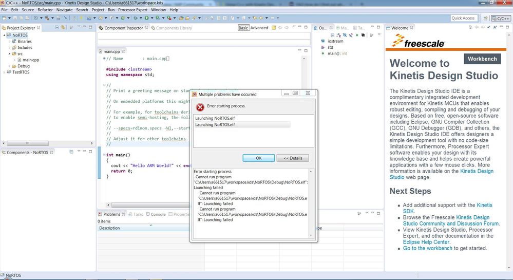

However if I create C++ Project and build it and then run it I get this error:
7,242 Views

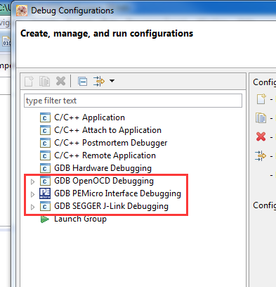

Hello Fsa,
What about your debug firmware on your board ,  OpenOCD , PE or J-link ?
Please select the right one refer to your firmware :
(right your project ->debug AS -. debug configuration ...)
About the three debug mode introduce and configuration , please check
KDS_Users_Guide.pdf -> 2.5 Debugging Projects
Hope it helps
Alice

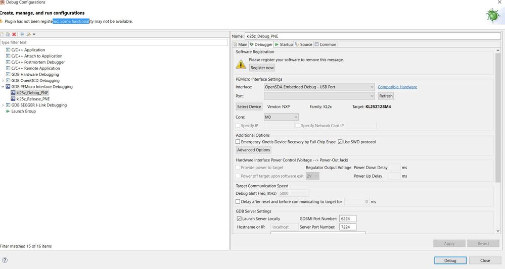

simplethings
Hello everyone again, so at one point I just gave up ARM microcontrollers and kept working with my old good buddies, AVRs. I want to give Kinetis Design and ARM MCUs another chance. So basically I managed to successfully add new SDK 2.0 C/C++ project, and it builded with no errors.
I have followed the KSD_USERS_Guide.pdf that you attached.
So I have installed GDB PEMicro drivers and set up all the data in Kinetis Design Debugger Options as described in the pdf. There are several MCU Targets, I have tried to enter Bootloader and clicked on of the HTMLs : FRDM-KL25Z|Freedom Development Platform|Kinetis MCU|NXP . Seems like my board is KL25Z128M4. My MCU is plugged in, but under Port label I cannot see any devices.
I tried to run debug but I get the following error:
Two days ago I changed my bootloader to mbed, since I was able to successfully flash my MCU with mbed platform. Maybe I do need to install bootloader version from: PEmicro - P&E Microcomputer Systems: Over 30 years as an Industry leader in Embedded Systems Develop... in order to run debugging in KDS?
I have the following hardware information on my board:
Board Name is: FRDM-KL25Z
MicroBoot Kernel Version is: 1.03
Bootloader Version is: 1.05
Application Version is: 0.00
Besides debugging, is there a possibility like in Atmel Studio to flash compiled code on MCU directly from KDS?

Hello fsa,
- For the C++ code on project , please  add the below code
#ifdef __cplusplus
extern "C" {
#endif
   /* your C++ codes*/
#ifdef __cplusplus
} /* extern "C" */
#endif‍‍‍‍‍‍‍‍‍
As this case https://community.nxp.com/message/859161
-  About your this question , does it  happen when you just create a new FreeRTOS project on KSDK ?
If not, could you please share your project with me, I will check it on my side .
Alice
