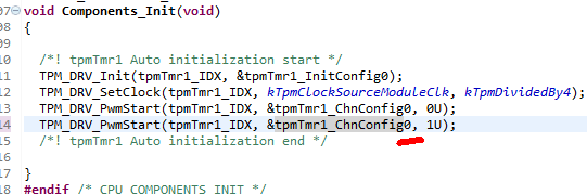

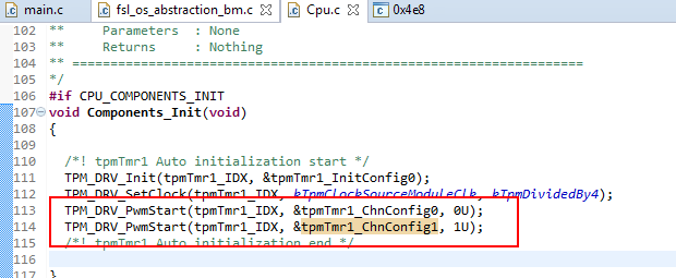

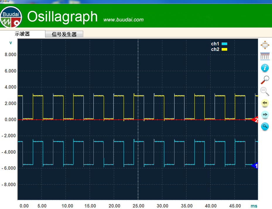

Hello Steven.
I have test it ,  the configuration of "Frequency" have no effect when set more then one.
If configure more than one , only the last one int the initialize function have effect, the initialize function at here:
after configuration the TPM component  ,the default " Components_Ini" function is
and i change "&tpmTmr1_ChnConfig0"  to "&tpmTmr1_ChnConfig1", then i check the tho channel  PWM signals , all of them are  240HZ.
So, we should configure the same data at the Frequency option when set more then one channel.
