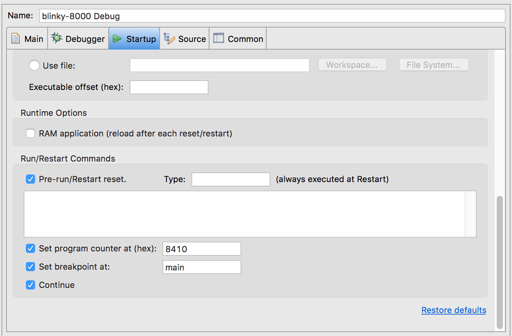

In the Debug Configurations, I set ["Set program counter at (hex):] to 8410, but that didn't seem have any effect.  (I also tried setting the [Executable offset (hex):] to 8000, but that had no apparent effect either.)

I may have solved it, but I'd like a complete explanation on why this works.  In the blinky-8000 .ld file, I reverted m_interrupts and m_flash_config to their original low memory values (0x0000 and 0x0400, respectively):
/* Specify the memory areas */
MEMORY
  m_interrupts          (RX)  : ORIGIN = 0x00000000, LENGTH = 0x00000200
  m_flash_config        (RX)  : ORIGIN = 0x00000400, LENGTH = 0x00000010
  m_text                (RX)  : ORIGIN = 0x00008410, LENGTH = 0x0000FBF0
  m_usb_sram            (RW)  : ORIGIN = 0x040FE000, LENGTH = 0x00000200
  m_data                (RW)  : ORIGIN = 0x1FFFF000, LENGTH = 0x00004000
And now after flashing the FRDM-KL27Z, it executes blinky-8000 properly.  And KDS-v3 properly associates the PC with the correct source code.

Hello Robert,
This device supports two booting methods: boot from internal flash and from ROM.
The address for booting flash is 0x0000. So , at power on chip, it run from 0x0000,
then you can use Vector Table Offset Register(VTOR) to relocate vector table.
For example, in the bootloader code , use VTOR relocate vector table to 0x8000,
    // relocate vector table
    SCB_VTOR = RELOCATED_VECTORS;   ‍‍
in application project (blinky) configure the linker file as you mentioned.
There is a bootloader and APP KL26, I think you can review that DOC to understand your question.
Hope it helps
TIC
4,032 Views
robertpoor
Senior Contributor I
Alice:
My question doesn't involve any bootloader (that will come next!).
What I need to understand is, after downloading blinky-8000 using the Segger J-Link, what must I do to make the program start executing?  As it stands now, it appears to always jump to 0x410 on startup and not to 0x8410.
