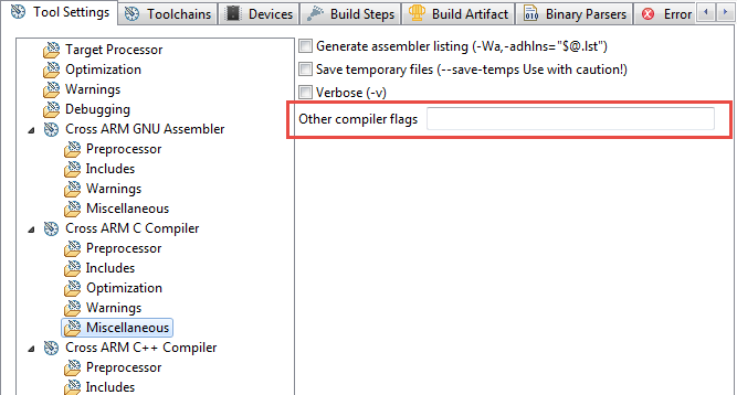

Furthermore, although I have found places where I can check
a checkbox and force KDS to set a command-line option for
me, I have yet to find a place where I can set command-line
options manually.

You can add your own options manually in several places, including this one:
About preprocoessor listing: this article might be what you need:
Preprocessor Listing for GNU gcc with GNU ARM Eclipse Plugins
Erich
