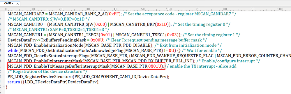

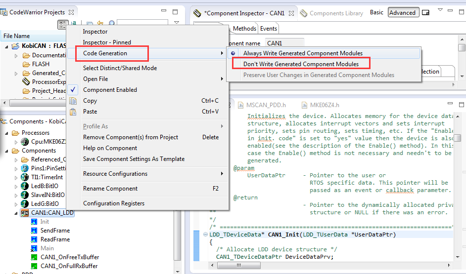

Hello Luca,
Sorry it seems there is a bug in the generated code of  the function "CAN1_Init()",
it have not enable the TX interrupt . Please add this code into this function have
a try :
MSCAN_PDD_EnableTxMessageBufferInterruptMask(MSCAN_BASE_PTR,0X01U);
After add this word , then enable the "Don't Write Generated Component Moudules":pastedImage_3.png
Then build your project , have a try , if still have question , please contact me without any hesitate.
Hope it helps
Alice Yang

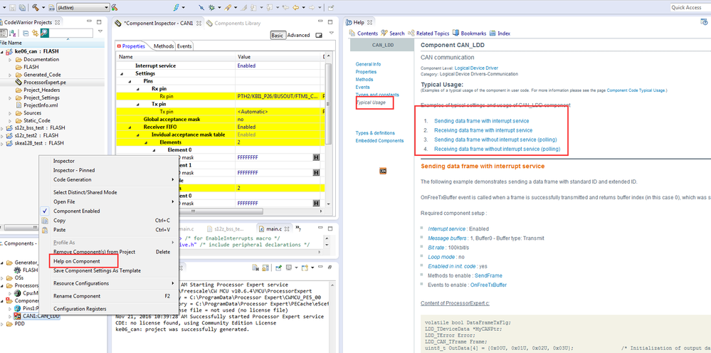

Hello Luca,
- There is example under CAN_LDD component , you can refer to it  :
- After refer to the Typical Usage , if still can not work , you can share your project to me , and i check it on my side for you .
Alice Yang
