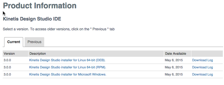

Hi Erich,
Is the mac version already available?
In the KDS Download webpage there is no link for mac.
Hi Ali,
I appologize for that, I have realized that too. Working with the web team to get that fixed. Will post a comment here when it is fixed.
Erich
Hi Ali,
the web download has been fixed, and the Mac OS X installer is available now.
Erich

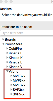

Hi Erich
1. Thanks for the MacOSX version!
2. What about support for Vybrid processors? For the standalone Driver Suite a Vybrid plugin exists, any plans to integrate into the latest KDS/SDK?
hi Erich
then that can be programmed Kinetis M,using process experts
thanks
Hi Robert,
there are currently no plans to have Vybrid added to Kinetis Design Studio.
Erich
