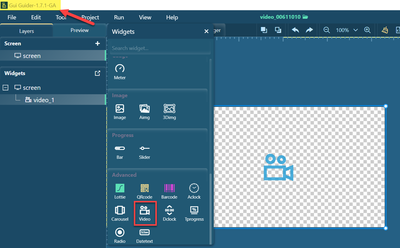

I'm trying to add a video to my gui-guider screen but there is no widget for that ! (I'm using V1.7.1 of guiguider)

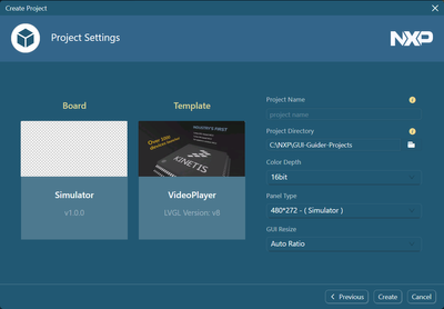

EdwinHz
Hi @amira,
The screenshot I shared previously is taken from version 1.7.1 of GUI Guider. Here is an extended picture that corroborates the release version:
What MCU are you using for your project? If you create a new project using the following board and template (just for testing purposes), is the Video widget still missing for you?
BR,
Edwin.

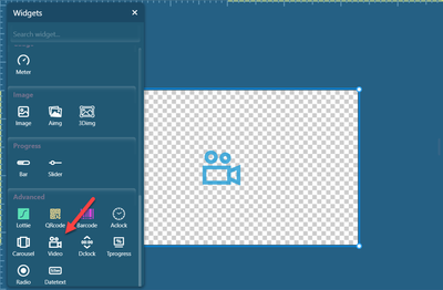

EdwinHz
Hi @amira,
Please look into the following documentation on how to add and use the VideoPlayer application template on GUI Guider: Video | GUIGUIDERUG: GUI Guider User's Guide | NXP Semiconductors
If the board you are currently using does not have a VideoPlayer sample, you can still find the video player widget on the "advanced" section of the Widgets menu (scroll to the bottom of this menu to find it):
Make sure to add the .h264 video file on the "<project folder>/import/video" path in order to be able to see it during simulation. An example of how the video path should look like is shown after step 4 of the "Create project" section of the aforementioned documentatation.
Hope this helps!
