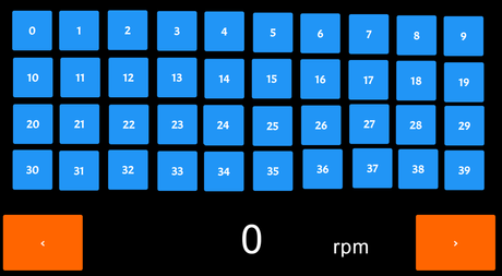

Hello.
A serious problem occured during development with the GUI Guider.
There is an issue where operation becomes very slow when multiple widgets(e.g. buttons) are displayed in a single screen container box.
Below is the test screen and code.

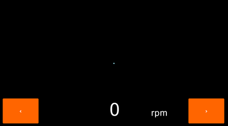

[Screen Container1] : button widget 40 ea
[Screen Container2] : button widget 0 ea
[Code]
The label marked '0' is continuously increased by 1 in an infinite loop.
The label value increases very slowly in screen 1 than in screen 2.
The more widgets you add, the slower it becomes.
The application you want to develop must display data in real(RPM, km/h, etc.) with multiple widgets such as images, labels and buttons.
I've tried various improvements, but couldn't find a solution, so I'm contacting you.
If there is no way to improve, we urgently need to review other UI tools, so we would appreciate your quick reply.

When you touch the left or right button, cont_1 and cont_2 are switched, and the speed varies greatly depending on whether the button widget is present or not.
Please check and confirm if you have the same issue as me.
