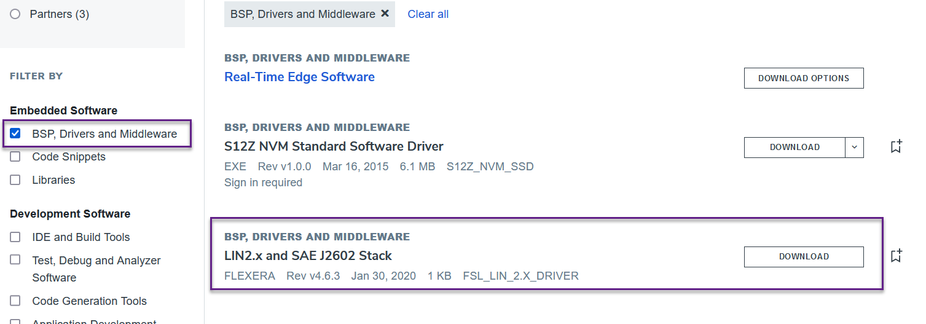

I debugged the motor program through S12ZVML64, but it can only be debugged through freemaster. But I want to control through LIN communication. How can I integrate LIN communication into the motor program.

Hello @mine233,
The S12Z LIN Stack is avaiable at the S12ZVM webpage:
https://www.nxp.com/products/processors-and-microcontrollers/additional-mpu-mcus-architectures/s12-m...
You can refer to AN5122 Using Freescale’s LIN Driver with the MagniV Family:
https://www.nxp.com/docs/en/application-note/AN5122.pdf
AN5122SW:
https://www.nxp.com/webapp/Download?colCode=AN5122SW&docLang=en

FreeMASTER  supports different communication interfaces - you do not describe which of them you use, so I assume you use the serial communication (SCI/UART) which is a default option.
In order to use the LIN protocol, you will need to integrate a LIN software stack into your application. A LIN stack is available from NXP. I will ask my colleagues to help you find it.
BTW: Note that FreeMASTER can also communicate over LIN, but there are several limitations and pre-conditions. The FreeMASTER requires the LIN stack to support "diagnostic class II & III" which is not very common. In short, when you start using LIN, you will most probably lose the FreeMASTER connectivity (or you can run it over another SCI port).
