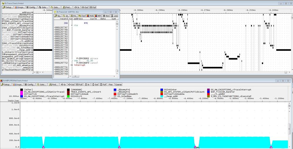

The upper window shows the functions executed.
The small windows above the upper window shows the single opcode (cmp) executed after returning from an interrupt but before the loop is interrupted again by another interrupt.
The lower window shows the performance (mips). The loop execution performance is displayed in light blue. After the last interrupt (shown as interceptions), the performance is degenerated by 1/3. The degeneration is caused by the "bls" command which in case of the error consumes processor cycles. (see picture below)

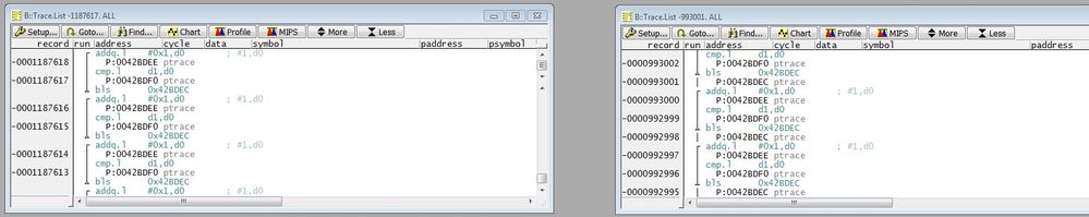

The left window shows the loop execution before the error happens.
The right window shows the loop execution after the error happened.
The error seems to occur when the loop execution is interrupted before the branch prediction works. In this traced example. The loop execution was interrupted by an external timer interrupt. When the timer interrupt was done, the loop execution continued for a single opcode before the loop was again interrupted by an other external interrupt. When this second interrupt returned, the loop executes correctly until the next interrupt (timer) occurs. When the timer interrupt returns, the loop executes only with 2/3 of the possible speed due to the not working branch cache.
