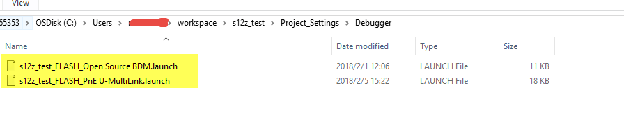

Can you please tell me as to why the Connection in the Target Settings disappears sometimes?
6,420 Views
Hello PRATIBHA SURABHI,
It seems when delete the .launch file ,  open the project again, the debug configration will disappeared.
Hope it helps
TIC
6,420 Views
pratibhasurabhi
Contributor V
Hi Alice_Yang,
Thank you.
Can you explain a situation or a a scenario where the above mentioned .launch files would get deleted?
I faced the problem of target connection  missing when i imported the existing project.
How can the .launch files get deleted when importing a existing project?

pratibhasurabhi
Contributor V
Alice_Yang‌
Even I performed the same steps.
I directly import an existing project.
Also i tried by deleting the launch file(1 file).it ddint work
I tried after deleting the PEMICRO files (2 files ) such that the debugger folder was empty.
Still i was able to see a target setting.
6,420 Views
After delete, please close the project, then import it agin.
Or import it on other workpace.
Alice
