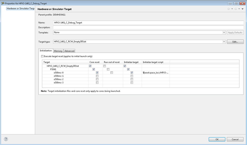

I'm using only the "HPX3-1401_C_Debug.tcl" initialization file.

here the initialization file i'm using:

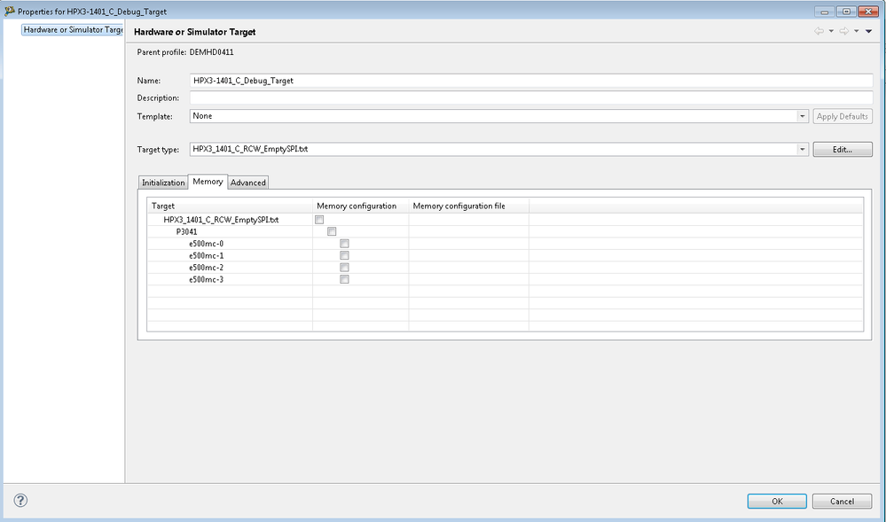

Please check your CodeWarrior launch configuration, did you use memory configuration file?
Yiping

yipingwang
Hello Josip Vrdoljak,
I checked P4080DS sample project, the following memory ranges are reserved in the memory configuration file.
Please don't use memory configuration file when use CodeWarrior to connect to the target board.
Please open memory configuration panel from Run->Debug Configurations-><Project>-core00_RAM_P4080_Download->Edit->Edit->Memory, and uncheck Memory configuration.
