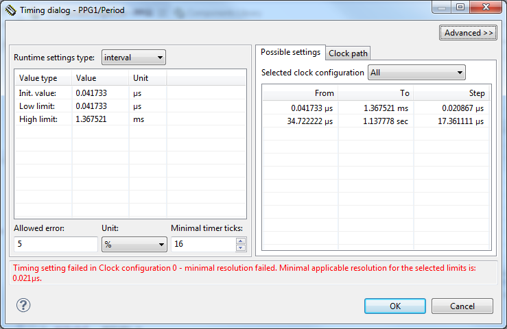

I have a K60Dx256VLL10 and I would like to generate a rectangular wave (with variable frequency) on port PTB19.
To do this I tried the PE and used the PPG component. But when I try to use the "Runtime settings type: interval" I only get the following error message : "Timing setting failed in Clock configuration 0 - minimal resolution failed. Minimal applicable resolution for the selected limit is: 0.021us".
What's my problem?
Thank you
Mario

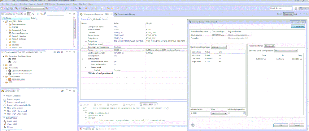

Hi Mario,
I have checked the problem and it seems that there is a precision computing problem. The precision is computed from the Low limit value. Please, set the allowed error in ms (select ms in Units) and set 0.0001ms allowed error, see the following screenshot.
I have also noticed that there can be problem with the Initial Value. In case that you have trouble to set the Init. Value in us, select ms and set the same value in ms.
I use the MK60DX256VLQ10 CPU and 20.9MHz bus clock. Therefore there are different minimal value. When you click on the Advance button in the Timing dialog you can also see the clock path and you can select clock source and prescaler values directly.
Marek Neuzil

mruetti
Hi Marek,
thank you for the help! The allowed error was indeed the problem. Now it works as expected!
