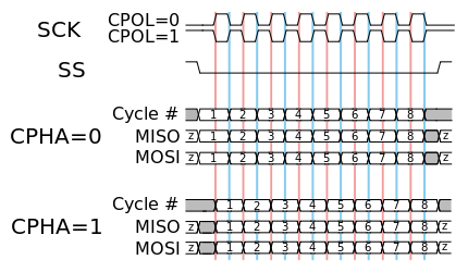

I find your attached SPI timing is so strange, the correct one should same with below picture:
Wish it helps.
Ma Hui

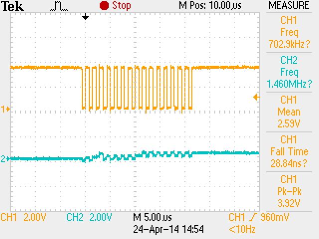

I am using Synchromaster  SPI component for SPI and following is the settings, When I probed the CS pin I found it is at one steady state of logic high. It is not changing its logic level. I somehow managed to get the o/p from slave's WHO_AM_I register but when I am leaving cs pin floating then only I am getting the values that too with uncertainty. Sometimes the values come but some times 0x00. the occurrence is not proper,I tried with external bit_io pin as cs pin but that also didn't worked.
the waveform of SCLK-MOSI is following, here I am sending 0xA0FF value . Starting A0--> r/w + other register's address as discussed above. FF--> these are don't care bits.

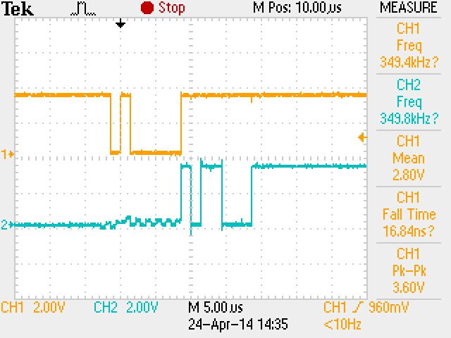

the waveform of sclk-MISO is following. In this as per the diagram mentioned earlier the data bits are acquired in the last 8 bits. The response as expected was 0xB1 which I am getting some times.

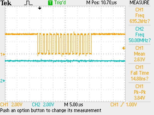

When the value dosen't come then waveform for sclk-MISO is following. Here I am getting 0x00

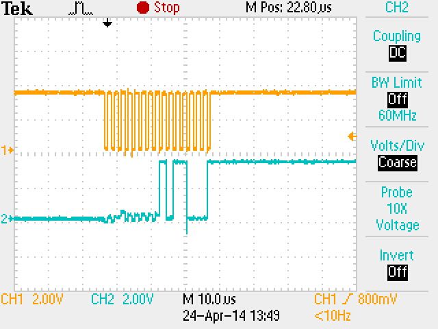

the combined waveform of MOSI-MISO is following

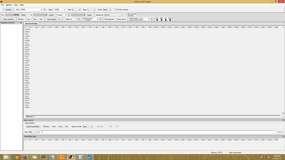

the o/p in terminal window (when CS pin is floating)
When CS pin connected to 0 or 3.3V I am getting the following o/p
