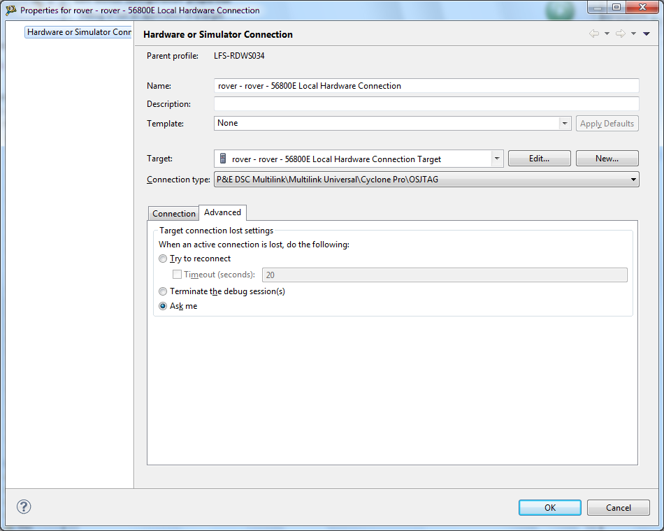

Yes I am using a P&E Multilink.  The link you gave was helpful but I do not see the same "Advanced Options" page that is shown in your link.  I do not see a way to define memory for preservation.  I see the followoing on the Advanced options page.   Is this feature hidden somewhere else?  I really appreciate your help.

It's on the Connection tab:

LesleyF
Hi Erich,
Thanks so much. I really appreciate your timely help with this. Freescale is a great company to work with. You guys are great.
