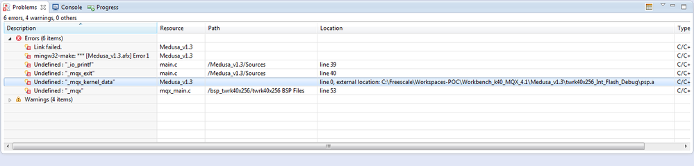

I recently upgrade my CW to version 10.5. I tried to compile my project but I got a Linker error as follow:
This is the list of errors I got after compile:

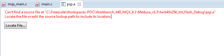

I'm not sure why CW is looking for psp.a in workspace. I assume this file should be in MQX BSP folder. Should I change any setting in my project properties? any suggestion?

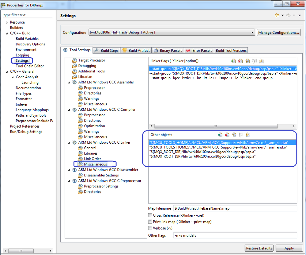

Is your project based on MQX? If so, please check whether the path for MQX libraries is correct.
You can do it from <Project> Menu->Properties, then go to <C/C++ Build-> Settings> panel, then choose ‘ARM Ltd Windwos GCC C Linker’-> Miscellaneous, please check whether the libraries path is correct.

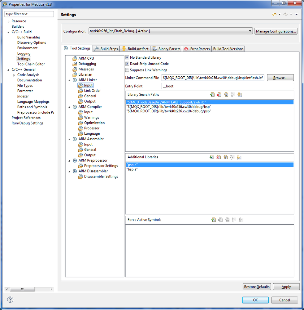

amleng
Yes, I use MQX 4.02. Here is my linker setting. I use freescale compiler rather than gcc. As I can see here everything is all right. Do you think I need to change something? The MQX_ROOT_DIR is   "C:\Freescale\Freescale_MQX_4_0". This is the location I installed MQX. I have this problem only for k40x256. The projects for K60 are compiled well.
