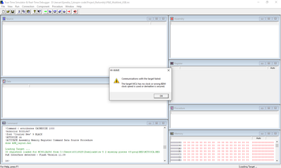

I am using Multilink Debug probe: USB-ML-UNIVERSAL from PEmicro to debug and flash the code using Hi-wave simulator of Code warrior studio on MC9S12A256 and i am facing one of the below 3 errors
Error 1: Target MCU has no clock.
Error 2: Wrong BDM clock speed.
Error 3: Device is secured.

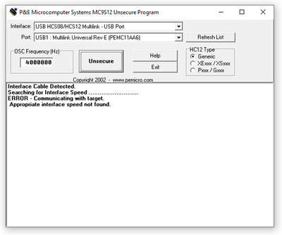

Even when i am using the Unsecure12 utility tool i am facing the below error

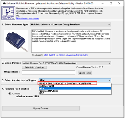

MC9S12A256 is not ARM product, so please don't select ARM as supporting achitecture. please select S12 instead as I marked below.

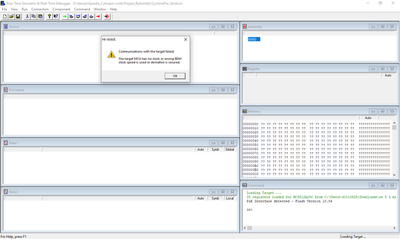

I am still getting this pop up error window in the Hi-wave simulator application of code warrior developement studio even after making the architecture to ARM.

Becuase both CodeWarrior and P&E programming tool can not connect. I suggest you chech USB-ML_UNIVERSIAL first.
This is P&E firmware utility tool, please using it to update Multilink universial firmware to support 8/16 bit device. Please send me a screenshot if you did it already.

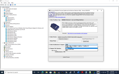

We have already installed the driver for PE micro hardware while installing Code Warrior tool only.
I have installed the P&E firmware utility tool as you suggested. Please check whether all configuration setting are correct in PE firmware utility tool and also do have a look at the Device manger screenshot also attached below.
